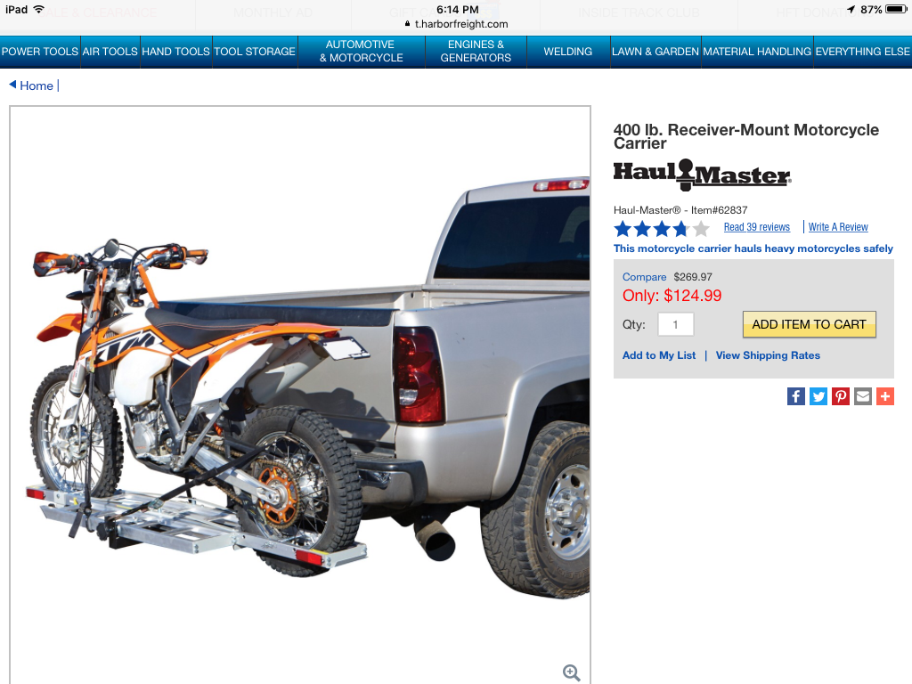

  8. Hulld
    Hulld Road Train Member
    2,884
    6,567
    Oct 19, 2015
    Upstate NY
