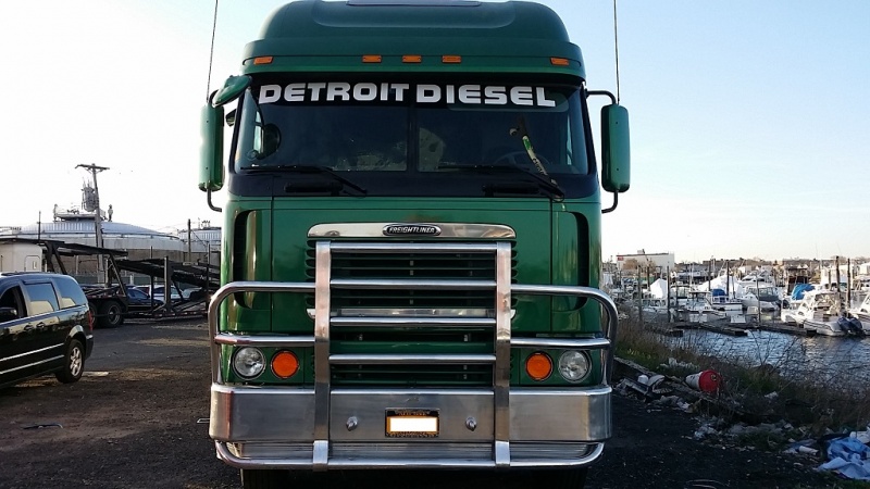

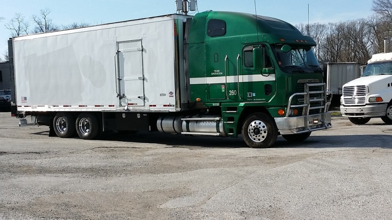

    Hi Everyone
    sorry I'm new to forums I really don't write on forums much I need help is it possible to retrofitting a
    a 2007 Freightliner Argosy cab over with a D60 series engine with a 13 speed Eaton fuller it possible to retrofitting to Allison automatic Transmission
    maybe a 4700 or Allison 4800
    and I really like to have automatic transmission any one can help me if this is durable to convert I'm tiered of driving 13 speed in the city
    also if any one know of a shop who can do this type of work anyone please help
    Thank you :blob8:

    Actually, the OP's truck IS listed in the truck paper, or at least one exactly like it, right down to the grill guard/bumper.
