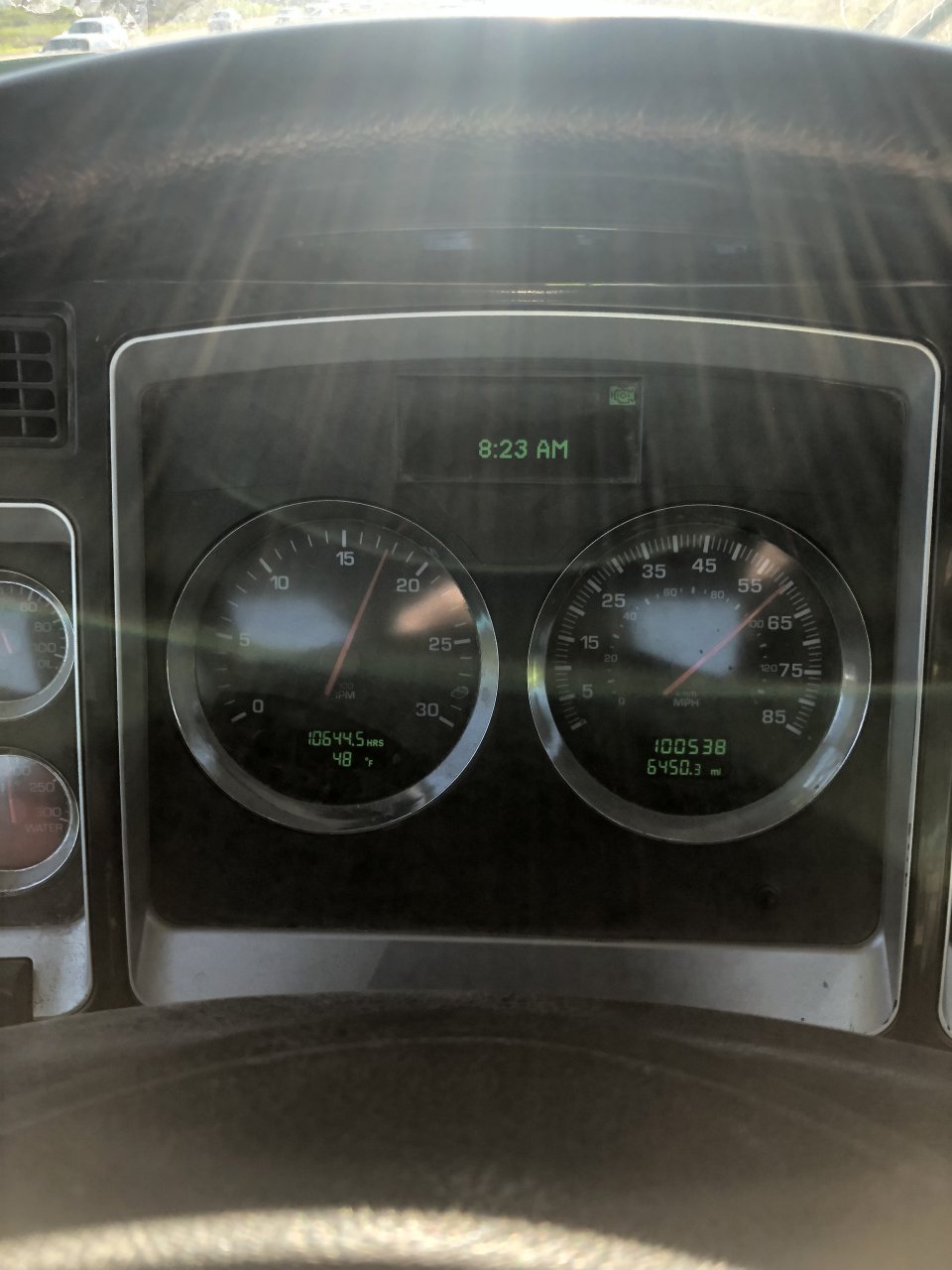

    6DFD5612-091E-45E2-B76C-A196D1ECB8DF.jpeg Yes Allison auto. 5.83 gears I think.
    This is in my mixer that’s usually between 80-90k gross.
    It shifts at 2200 rpm or so and will hold there on hills loaded.
    Accidental Trucker Thanks this.
