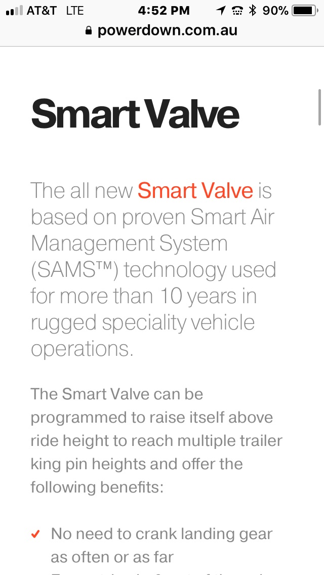

  6. kemosabi49
    10,599
    45,343
    Jan 13, 2013
    SW Arkansas
    I know a few tanker O/Os with setups like this on their trucks. Makes it easier to get all of the liquid out on a rear dump trailer.
