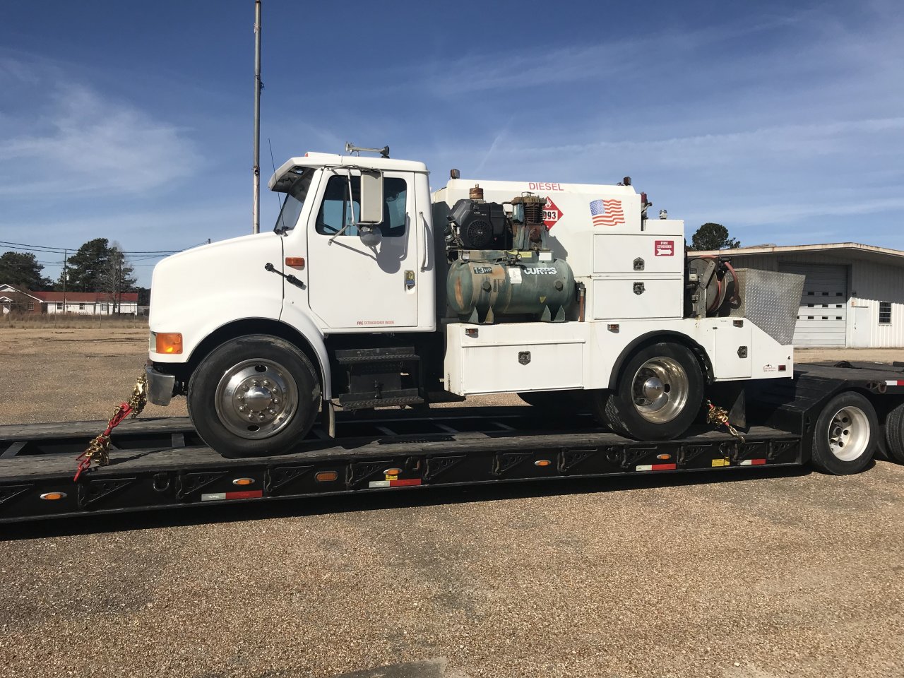

    9EEF29DD-190B-4D9E-B027-F756D16FFA65.jpeg It’s been so long since I picked a vehicle up... at least one kinda like this.... I’ve got a copy of a certification paper from shipper saying it’s been cleaned

    As long as you have documents showing the tank has been washed out and placards removed your good to go.

    And it doesn't hurt to pop the cap on the tank and check for residue, just to confirm the shipped didn't give you a bum washout ticket.

    If it's certified clean I'd cover/remove the placards.

    X2 ....Cover or remove placards.....:)
