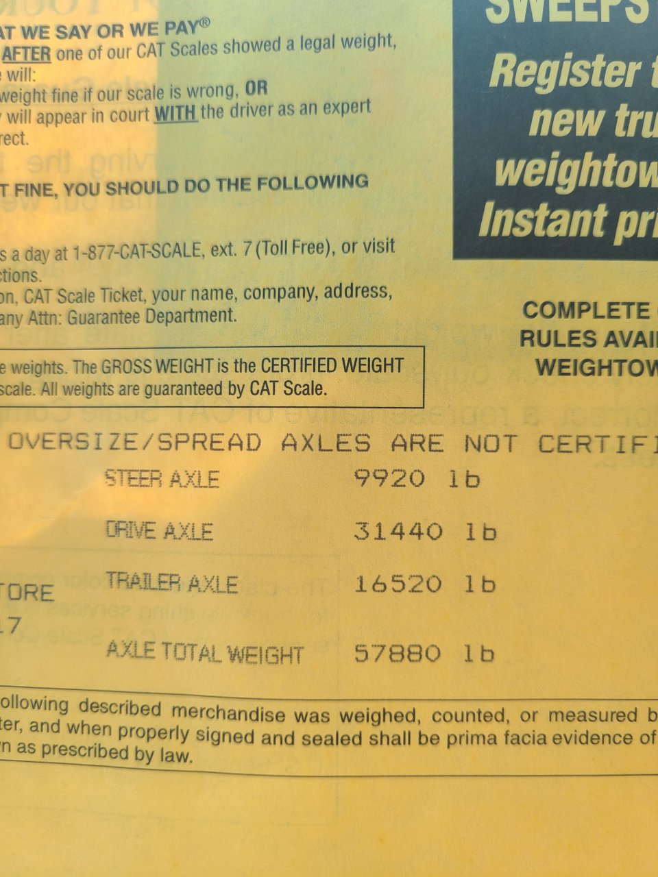

    34 front axle, 16 on the rear. Neck brace?

    It brakes a bit off. The load is riding well so far.
    Those scale tickets are driving me nuts. The scale was covered in snow so I couldnt see the lines, and the scale master had no idea what to do.
    I guess since the gross weight is so low I'd be fine. It doesnt feel especially heavy driving it, but I noticed the braking feels slightly different.

    Are you sure your back trailer axle was on the scale? That was my initial thought when I saw that ticket. 16 seems pretty light for a front to back load like that, 32k would make more sense to me.

    I always assumed they zero out the scale after each use.... or do they zero out automatically?
    Either way you would think CAT Scale would want them to be kept clean

    They're supposed to automatically re-set themselves every twelve hours. But...:rolleyes:

    The steer looks light too…. Unless he’s slid all the way to the rear on the fifth wheel slide?
