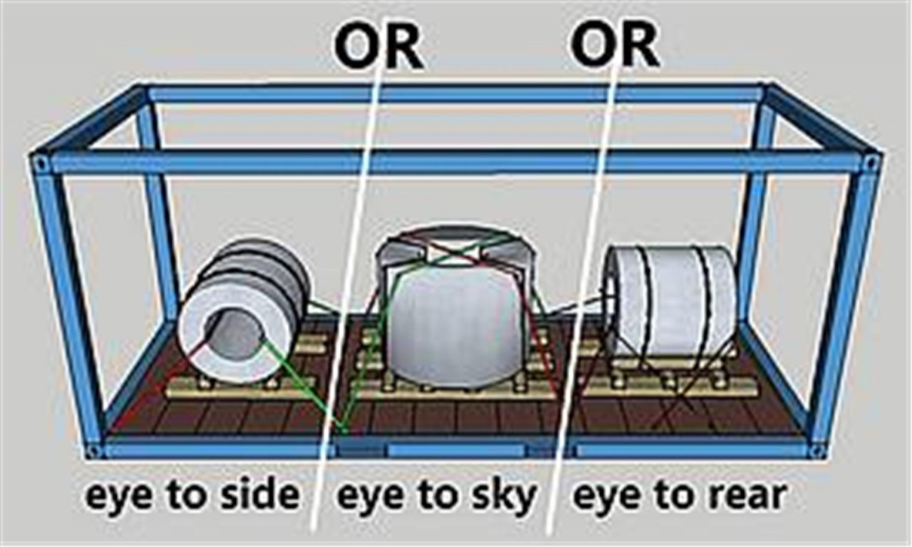

    Would someone please explain these terms.
    No i haven't hauled a coil, likely never will, but still want to understand the lingo.
  6. skallagrime
    skallagrime Road Train Member
    3,855
    9,929
    Apr 10, 2012
    Indiana
    Shotgun, coil on end, eyes pointed to front and rear (shotgun barrel at driver)
    Suicide, on end, loaded so in a hard stop and no chains it would steamroll the driver
    LoneRanger and Pamela1990 Thank this.
  7. Pamela1990
    Pamela1990 Road Train Member
    1,820
    10,721
    Nov 7, 2021
    B.C. Canada
    Thanks.
  8. stwik
    11,889
    168,529
    eye to the side / suicide
    eye to the sky / palletized
    Eye to the front/rear / shotgun
