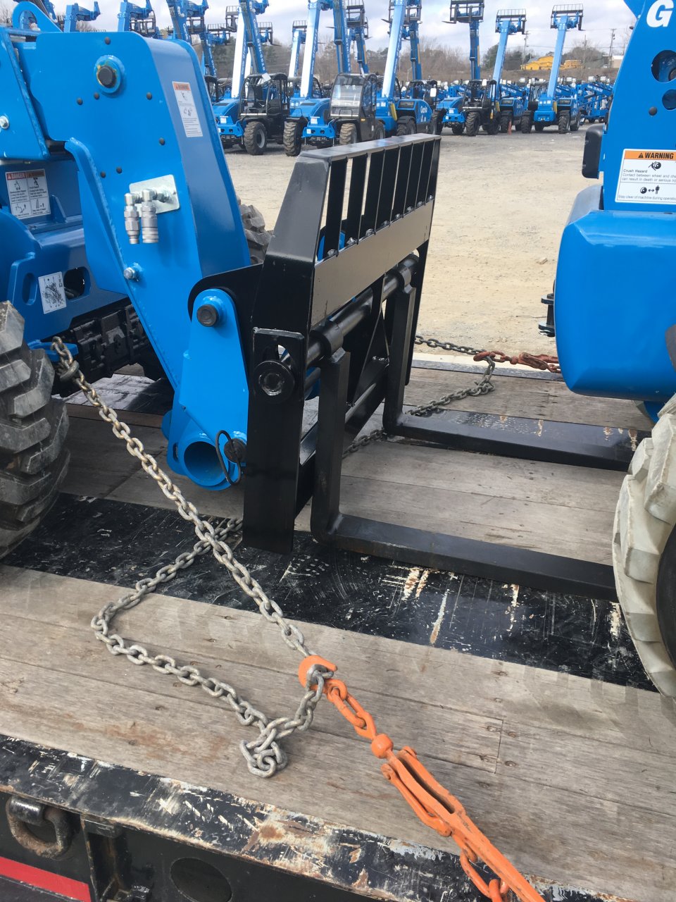

    Hey Six, how tight is too tight on ratchets? Straps?

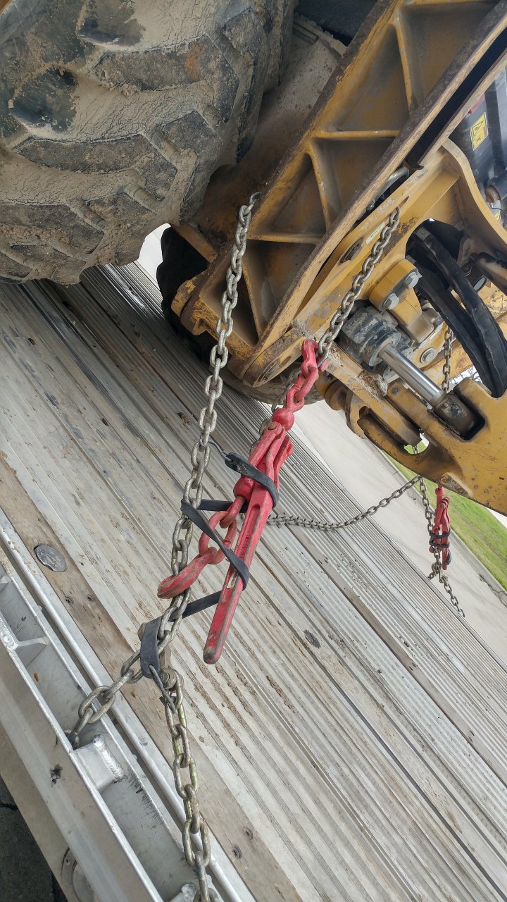

  5. Woodys
    Woodys Heavy Load Member
    774
    1,629
    Mar 16, 2010
    Tampa, FL
    Bueno?
    The cross chaining definately makes sense, my question is this. On the equipment I ran the last couple days, their anchor points would make it akward as crap to cross chain. Like the anchor points are mor to the side then in front or back, so the chain would be rubbing against the tractor. What would you do in a situation like that?
    Thx for all the help fam!
  6. johndeere4020
    8,522
    119,296
    Jan 1, 2010
    On that load there is absolutely no advantage to cross chaining. On that particular machine I’m not sure I would have wrapped the outrigger, it’s fine but probably not how I would have done it. Unless you’re short chains I would use 1 per corner instead of trying to use 1 for two corners. That would have let you chain that a little different

  7. Woodys
    774
    1,629
    Mar 16, 2010
    Tampa, FL
    This is EXACTLY how I was taught when I hauled two water trucks a while ago. I made the loop around the axles and hooked the snap binders to the stake pocket. Actually still have the pics.
    My issue with that was that it was akward as crap to use the snap binders to connect to the trailer, I was not a fan.
  8. Woodys
    774
    1,629
    Mar 16, 2010
    Tampa, FL
    I'm guessing cause the anchor points are far enough away from the side of the trailer? Like I said before, I was worried if I tried to cross chain it would be runlbbing up against everything and I didn't like that idea.
    That spot on the outrigger is actually where the anchor point is (just behind it out of sight) There were hydraulic lines in the way though so I had to run it through and around to make sure I didnt smash anything.
    Where would you have grabbed onto it at?

  9. johndeere4020
    8,522
    119,296
    Jan 1, 2010
    Yeah i see the anchor point, I’d have to look at it from the rear. You should be able to move those lines enough to hook you chain through the hole and to itself.
    Personally I’d have used my chains with slip hooks but you don’t have that option.

  11. Woodys
    774
    1,629
    Mar 16, 2010
    Tampa, FL
    Ok I still have a major question about the WLL when you use one chain and 2 snap binders to create 2 seperate tiedown points. Where do you pull the WLL from? I don't understand how 2x chains rated at 6600 (or whatever they are) somehow are acceptable for a machine weighing in at 16k? Do you count the WLL for each tiedown point, so like 6600 on each tiedown?
