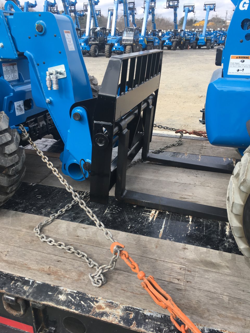

Is this ok? (chaining)

    As long as there is slack in the chain like in your picture they’re considered two separate tie downs so you get 6600# per chain/binder. A machine weighing 16,000 needs at least 4 tie downs.

    I had to go thru a bunch of pictures before I could find a good simple illustration of what we were talking about.

    Keep in mind, regardless of WLL, over 10k requires 4 points, regardless of how big a chain you use. THEN add if needed to cover the WLL or if it articulates.
