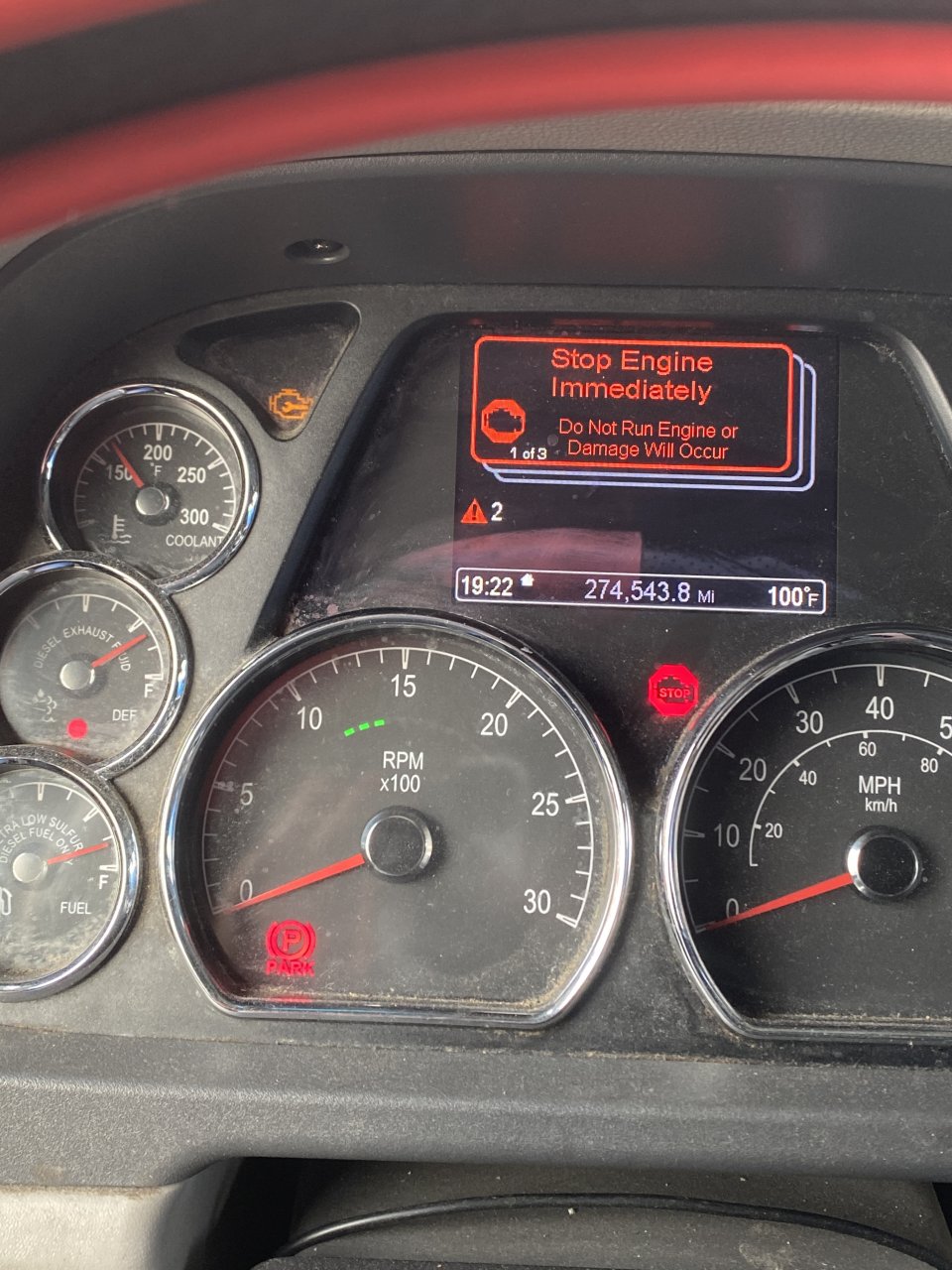

Is this what pops up when you get bad def fluid?

  6. drvrtech77
    drvrtech77 Road Train Member
    14,608
    141,304
    Mar 20, 2010
    Truck went into derate as soon as I parked this afternoon...Same issue ...

  9. drvrtech77
    14,608
    141,304
    Mar 20, 2010
    once I set the brakes, this came on...
