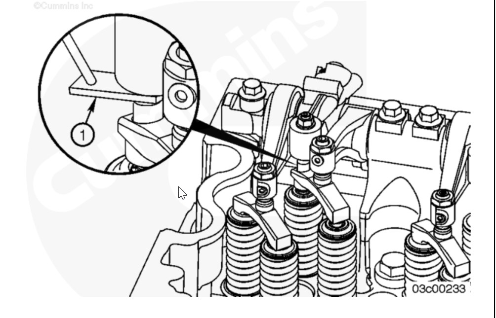

    ISX's have 2 jake solenoids and then 6 jake rocker arms which do all the work. (650$ ish Canadian each)

    Yes different then the Cat setup as far as hard parts. Theory is still the same.
    When the solenoids are activated the put oil towards the jake rockers. Jake rocker sit doing nothing on a detent til oil pressure activates them and then they ride on their own cam lobe to actuate one exhaust valve.
    Check engine light only when jaking means either wiring/solenoids are faulty or possible low oil pressure when jakes are activated but haven't come across that yet.
