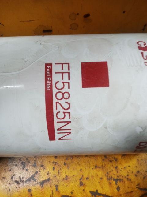

  5. little cat 500
    little cat 500 Road Train Member
    2,055
    1,100
    Jan 17, 2010
    Abbottstown PA
    fuel filter2.jpg come to find out its a knock off piece of crap

  6. Lyle H
    Lyle H Road Train Member
    1,291
    2,941
    Apr 16, 2014
    IMG_3681.jpeg The real Fleetguard ones say Cummins and/or Fleetguard on them…
    No idea what brand these are
    Diesel Dave and Heavyd Thank this.

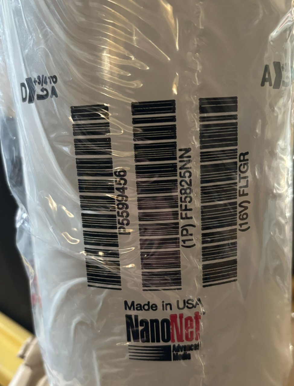

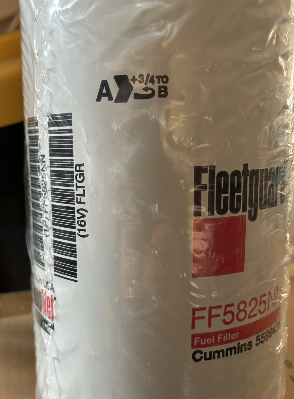

  7. Diesel Dave
    9,302
    29,930
    Jan 20, 2010
    Hesperia, Ca.
    I have some on the shelf that I bought from KW. I’m gonna go check them.
