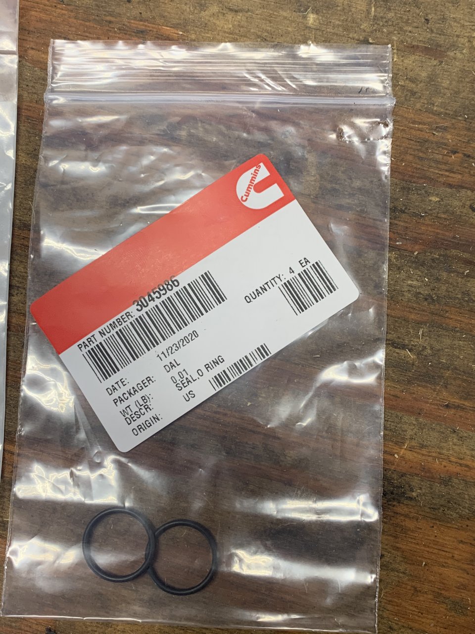

    This is the style I have. Should I be using the o rings instead of metal gaskets??

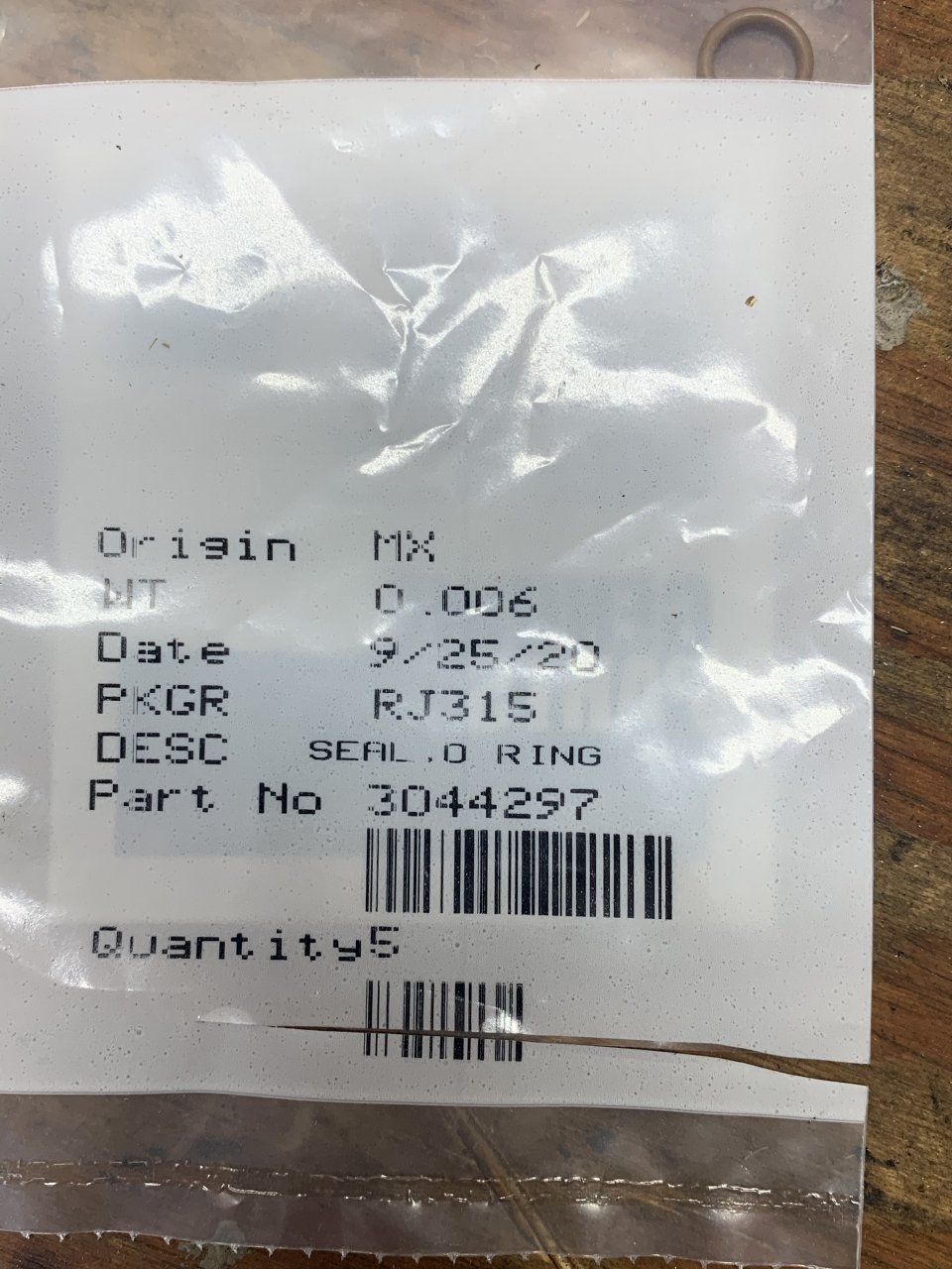

    May 31, 2020
    Got it sealed up. If your actuators are flat with no recess, you need to use metal gaskets. If they have recesses like mine you need o rings. Part #’s below
