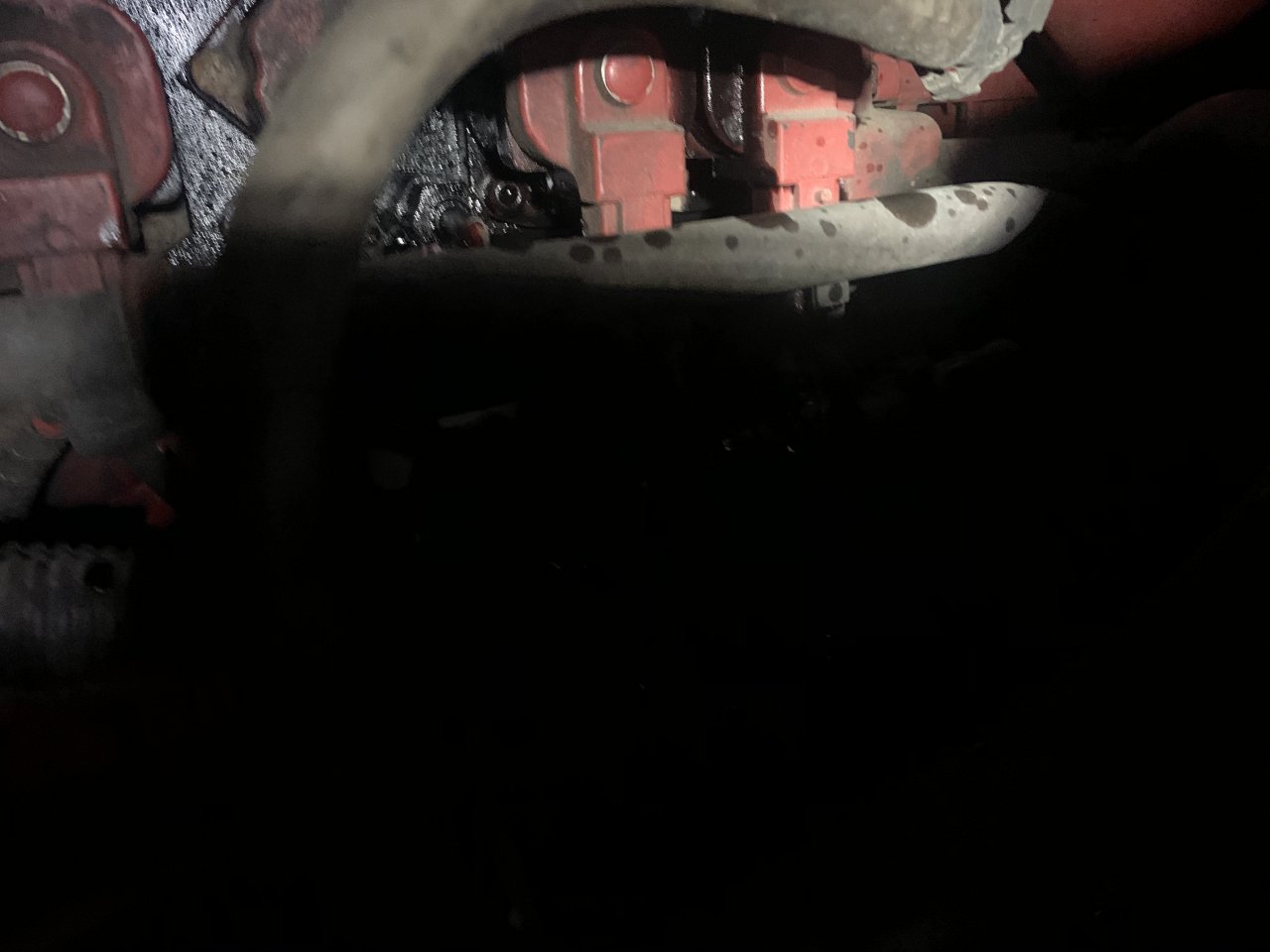

    Hey can u please help i just broke down do u what it is. Truck lost power and tur ed off and leaking oil very bad

    Do u know what that is
