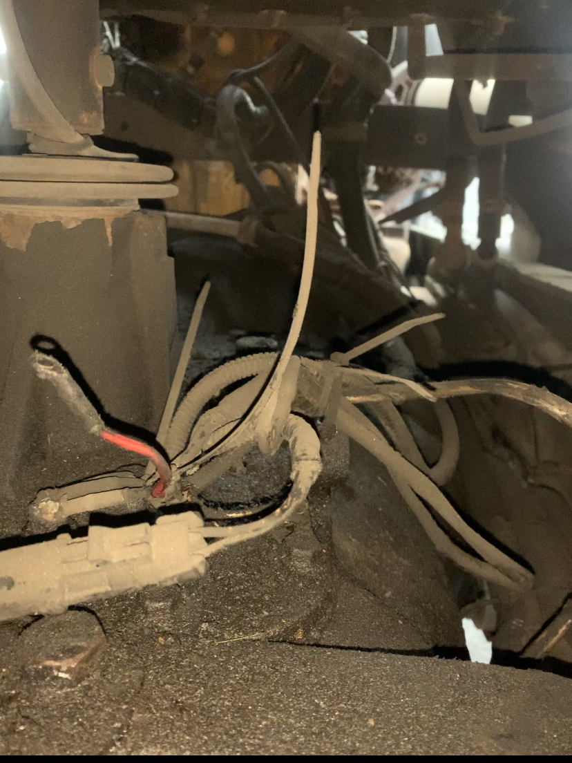

    Change all the air dryers you want. No power to the heater was the root of the problem or at least a big part of it.
    Stupid mistake on the part of all the so called mechanics.

    A lot of times mechanics check for power using only a test light.
    This is where the mistake is made.
    The problem is in a lot of situations you can light a test light ( or read power on a meter) but the circuit is compromised by corroded wiring or connections and the circuit is just not able to carry enough amperage of a high load such as a heater.
    Some people use an old headlight bulb to load a circuit but I use an old wiper motor when I’m testing for amp draw integrity.

    F01D52AE-03B4-4B60-9347-86E2BA64A3DE.jpeg followed the wiring,heater is grounded to the transmission postive is not hooked to a power source.
    Final Drive and Cat sdp Thank this.
