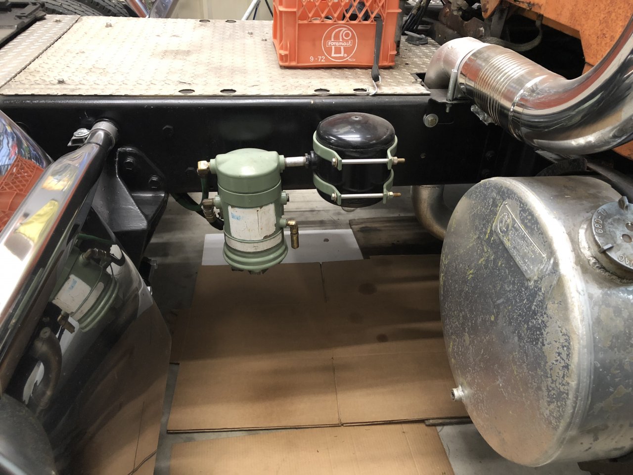

    I like this one on my ‘72 White.
    Still works like a champ after 49 years. Ultra rare AD-1 Uses later AD-2 desiccant cartridge and purge valve with seperate purge storage tank. (AD-2 has tank built in on top and adds 10”or 11” inches to it’s length so it is 21” tall.) Pressure builds up in purge tank when governor kicks cut-in pressure on and purges out the bottom purge valve through the catridge at cut out. Heater still works too.
    AD-2 type Cartridge and purge valve maintainance kits are still available for it.
    Came out late 60’s early 70’s. Not sure exact date. No one bought them due to cost back then. Only one out of every 100 trucks had one it seemed like. This is what started it all. Some real history.
