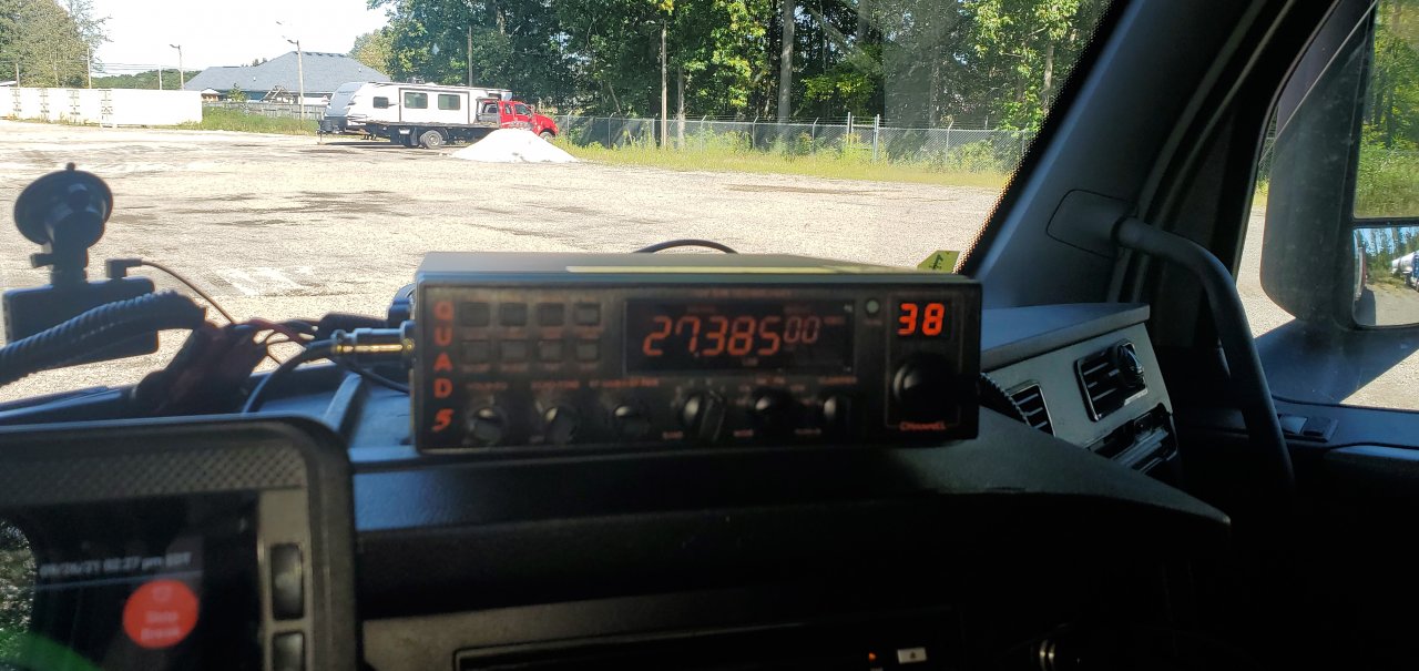

    Be real careful running that into a stock antenna! The 6666 is a high powered radio along the same lines as a Stryker 655/955. Crappy antenna (Cascadia stock antenna) will probably let the smoke out of that radio in the near future! They are prone to the finals failing if a less than stellar antenna is used. I would avoid mounting it in the radio cubby up top because the heat sink isn't very good. They will get hot if you "ratchet jaw"! Heavy duty velcro and mount on top of the dash! 20210926_142756.jpg
    Different radio but just to give you an idea. Mount my 6666 the same way!
    Put a decent antenna system on your truck and also don't power that radio off the stock radio feeds.
    I hope you didn't have Walcott tune it up because it's not necessary.
    The 6666 is a #### nice radio and with a proper antenna system you will enjoy it!
