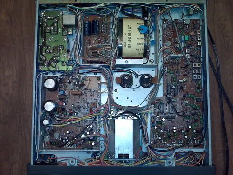

    Looks very nice. Also looks like the vfo has been aligned nicely with the digital display also. Nice rig.

    This guy seemed to be VERY thorough and meticulous about details. the radio is exactly on frequency. WWV shows up right on the nose...

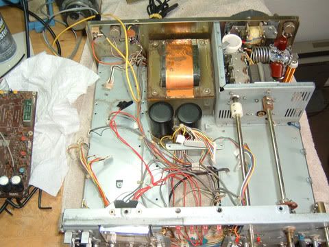

    That big plate choke coil between the two output tubes is black and burned because someone tried to install the bandswitch shaft 180 degrees out of alignment. A replacement is no longer available, so he had to rewind the old one with new wire. It took him 3 hours to do this while he was watching TV... Also, if you look closely at the bandswitch shaft, you will see it passes through many small vertical circuit boards (wafers). Each one of those has a disk with contacts that turn with the shaft. Its a very complicated switch. Those wafer contacts are a common problem with these radios, as they get dirty and corroded over time. This is "bread and butter" work for the techs that work on them.

    I know in cars and motorcycles, a barn find is a good thing, but what the heck happened to cause the before pictures mess?

    You had a tech rebuild it? They most certainly did a super nice job... but I hate to think how much money you must have tied up in it. They only sell for $250-$300 at hamfests.
  11. delta5
    delta5 Road Train Member
    1,193
    7,404
    Sep 9, 2010
    Remember it was given to me for free. The tech gave me a good deal including new tubes. When I was in highschool I used to drool over these radios. Many hams still consider these rigs the best sounding radios on the air. Compared to the new stuff out there now this radio is a bargain.
