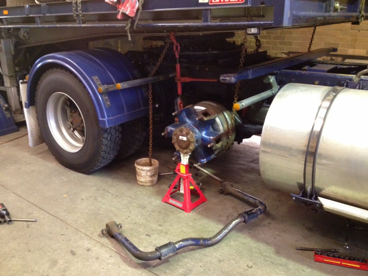

    image.jpeg Those "elephant ears" are called pedestals. You can have a single pedestal or heavy duty dual pedestal suspension. The single pedestal has one pair of brackets for 2 axles, the dual pedestal has got 4 brackets, one pair per axle.
    The steel pedestals used to crack, but the aluminum ones don't.
    I've got the Airglide 100 dual aluminum pedestal on my KW. The sway bars or torsion bars whatever you want to call them have been known to break, I replaced both as preventive maintenance a couple of years ago, they were slightly worn where the rubber bushes go. The old sway bar is in the pic.
