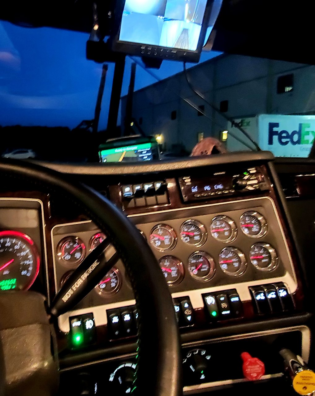

    20201224_171541.jpg On the 2017 Glider it is next to the spare on mine which has chicken lights hooked up to it. On yours that spare is your regen switch.
    Bottom left two switch panel.

    FUKING REGEN SWITCH!!! ARRRRR!!

    Yours is a spare, not the regen button ha.

    I "HOPE" i dont have to "activate" the switch, I ordered the foglights, switch, and wiring and well as the other optional beacon, aux lights switches and wiring. ... supposedly all ready to go and just need to add the lights themselves..

    I know this is an old thread but I spoke with a buddy that works for Paccar, He told me as long as the truck is pre-2020 no programming is required. Just adding this as an FYI for others searching such as myself
