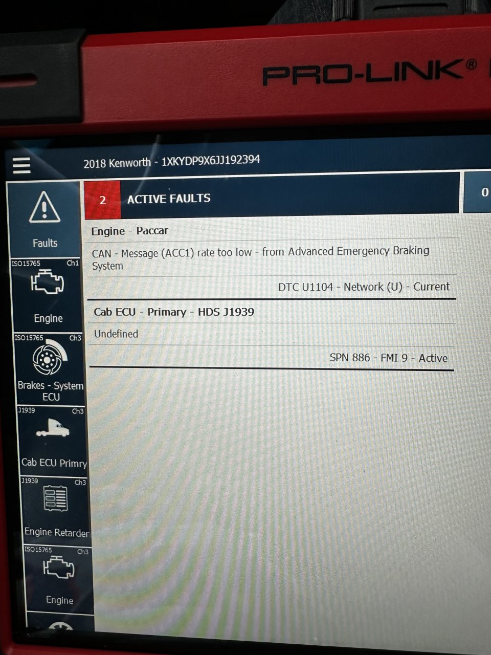

  7. boss429
    boss429 Bobtail Member
    2
    Oct 7, 2022
    Hate to bump an old thread but having a similar issue with my 18 t680. I’m throwing a u1104 and the j1939. Mines a manual but I still lose throttle response, clutch fan kicks on and wrench light stays on. Any tips or where to look? idk if removing my old ELD caused this issue or what, But it happened right after.
