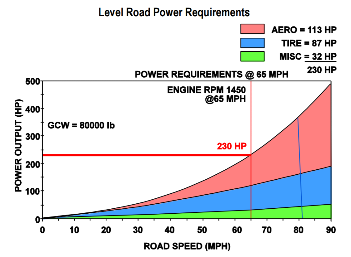

    It is generic advice and it is the reason why automatics are getting better mpg than fleet drivers shifting manually.
    You should look up (or create) a BSFC map showing fuel consumed vs power made throughout the rpm range for your engine:
    Then you monitor your horsepower output (with scangauge, bully dog, etc) and shift to be in the appropriate rpm for your power. This will mean frequent shifting and you will probably cruise on flat ground at a much lower rpm than with a hill or wind.
    The Detroit recommendations:
    ...just use a generic power graph:
    That graph says that at 55mph, I should be using ~160 horsepower, but my truck is much more efficient and actually uses ~80 horsepower to cruise at 55.
    At 80hp, 1200 rpm is 3% more efficient than 1400rpm (BSFC of 0.35 vs 0.36).
    Now if I was just handing the keys to a driver, I wouldn't say run at 1200rpm because they'd just set cruise control and wear out the engine lugging up hills. But for someone closely monitoring their gauges/driving there are gains to be made...
