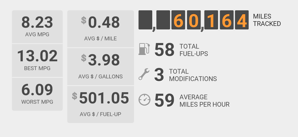

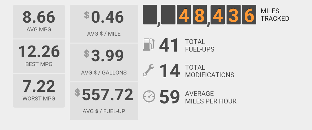

    They did lots of other modifications before and after installing their Arc? bumper, but here are the raw numbers anyway:
    before:
    after:

    At what times of the year? Same loads?
    The only way to get solid numbers is on an enclosed climate controlled test track where every variable can be the same throughout the testing. And that will never happen. I keep pretty good records of my fuel mileage and have fluctuations of 0.5mpg from one 20K mile stretch to the next.

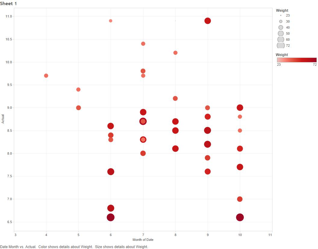

    Here I spread it out over time. Larger and darker is heavier weight.
