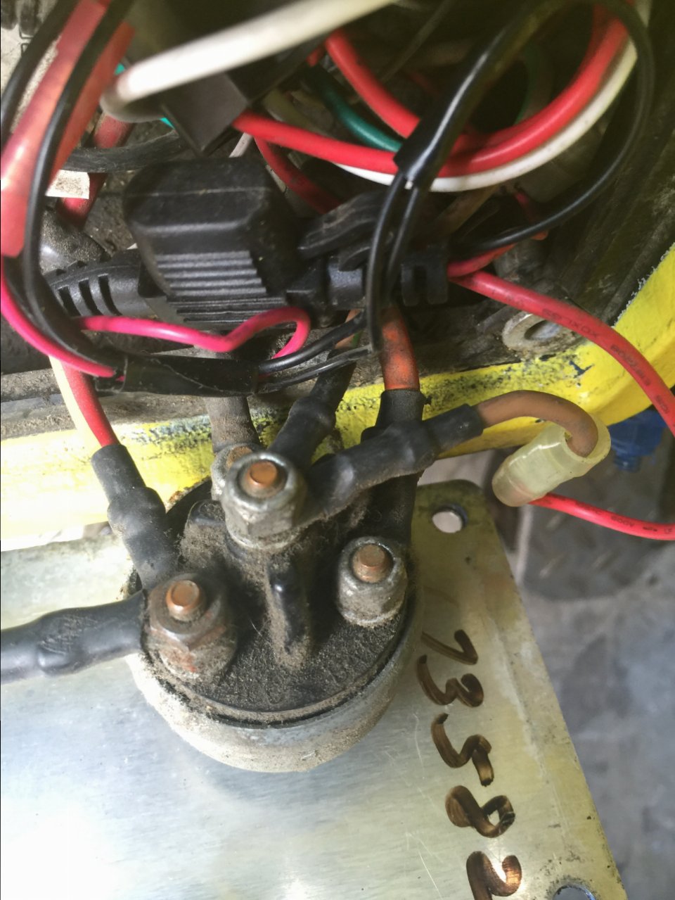

  11. Highwolf89
    Highwolf89 Light Load Member
    294
    61
    Jul 30, 2013
    What one goes to the button on the back of the key switch here is the pic image.jpg
