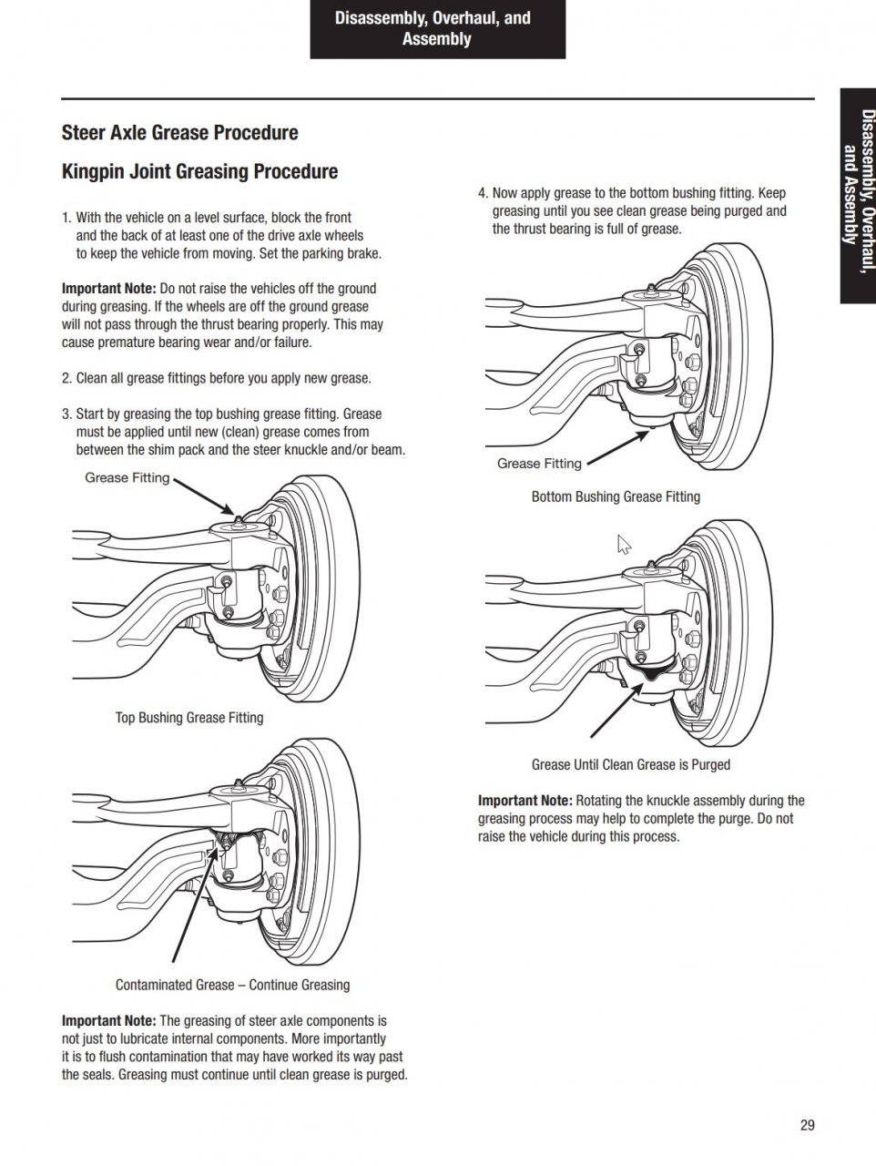

    Leave it on the ground as per Spicer.
