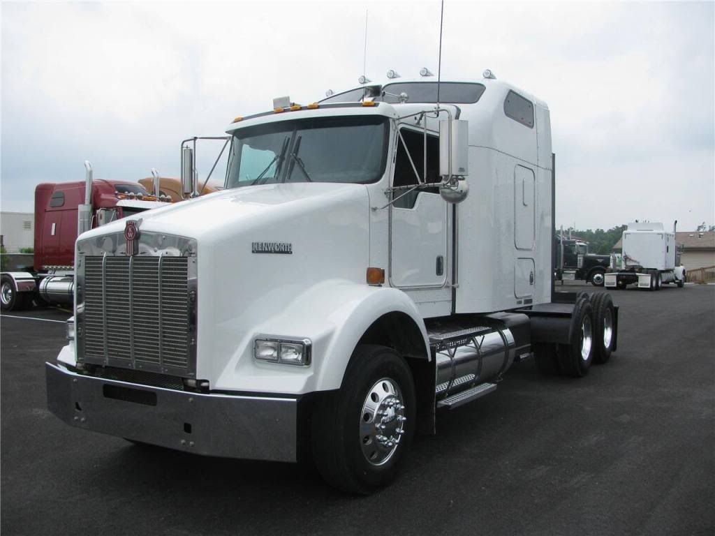

  4. kelgar50
    kelgar50 Medium Load Member
    334
    218
    Feb 1, 2007
    Bakersfield,CA
    Something like this

  11. kelgar50
    334
    218
    Feb 1, 2007
    Bakersfield,CA
    To each there one but they sure are easy to move around in tight spots and ride just as good as a t600.When I got a t800 quite a few yrs ago I thought great this should ride like a buck board but I was surprised it rode very smooth.The only reason I would keep the stacks and cans off the side is for mpg.
