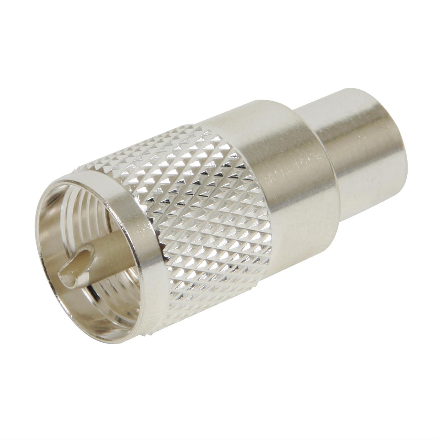

    I just switched into a 2015 t680 company truck. I found the CB coax, two wires from two antennas I'm guessing, with no connectors (bare ends as if the . RG-59U 22 ga. wires. I have a uniden bearcat radio I'd like to be able to connect. Can anyone suggest a connector to solve this issue?

    You'll need a couple of these and a couple reducers..[​IMG]
    https://www.dxengineering.com/parts/dxe-pl259
    $2.75 each plus the cost of the reducers
