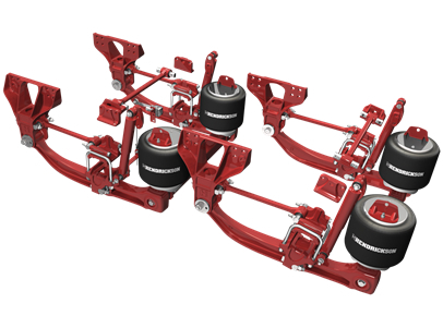

    Orion's Belt
    20/46 axles..... 18 front springs and 46 primaxx on rear. 236" wheelbase and it rides great . And it will handle the weight too....
    I had to replace the 2 torque rods that go from the frame to the top of the diff housing. That's all in 6.5 years.....
    Truck does 107k every day.....on 6 axles.
    T-800 is a nice HH ride.... If your doing a day cab get the extended one....or the studio sleeper route!

    Thanks Cat sdp!
    I will consider the Primaax or Neway for that matter. Need more inputs on those though. Last time I mentioned both at the dealers and got a negative reaction from parts and service. The T800 I'm going for is 14.6/46 with 18 and an ISX on 226-236 wheelbase (depending on pump setup) with 72" sleeper.

    I know for awhile kw would not spec a ag460 for a dump trailer app, because of stability . But they have changed and now offer it....
    My primaxx.... Less expensive then neway...

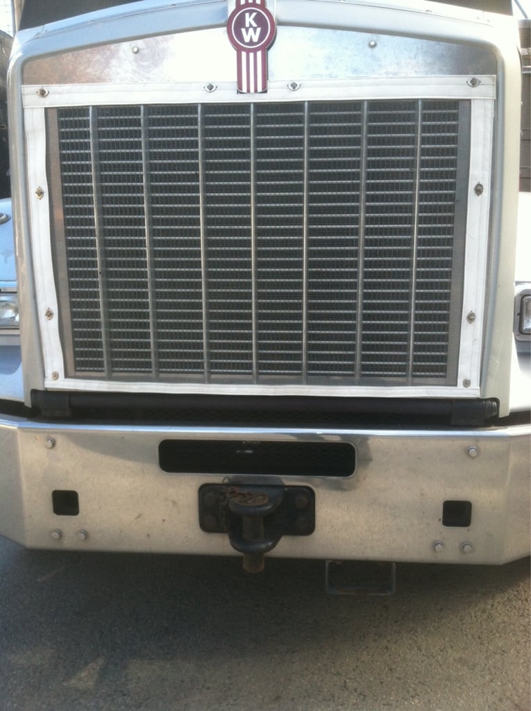

    Nrg if you go kw get the center mount tow hook...... Off-road it's priceless ......
    H2oburymatt and Prairie Boy Thank this.
