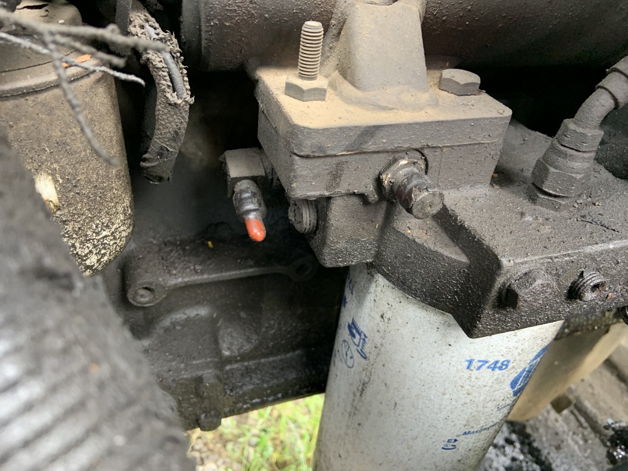

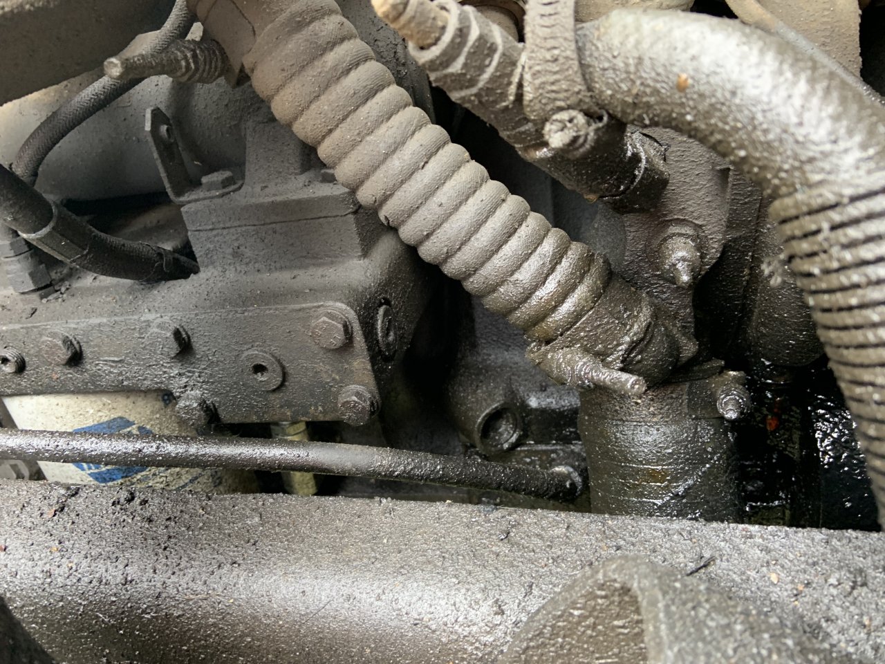

    5F3D8A12-95E9-4285-9A52-E9E1A076D102.jpeg 6575C17D-EE71-46B9-86C5-E820E36ED2B8.jpeg B8474C02-4DC8-46B8-BB56-13404EA286CD.jpeg Anyone know where oil pressure regulator is? I can’t find it. Thinking maybe it’s stuck?
    Any opinions?

    I just posted pictures. I can’t seem to find it. It wouldn’t be internal would it?

    Last picture on bottom to far right lower corner. You have three lines bleeding bad to me.
    Im working on high lines to powersteering that has to be replaced to bleeding myself and they look just like that.
    Ive been away too long from cabovers. So I'll leave it there.

    Thanks I’ll look closer

    I think that’s where I’ll start and at least inspect it first
