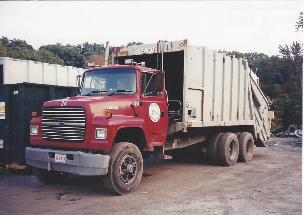

    Yeah it’s pretty much the big guys and city operations at our landfills.
    I don’t know if these trucks get hung up with flats in the landfills as much.
