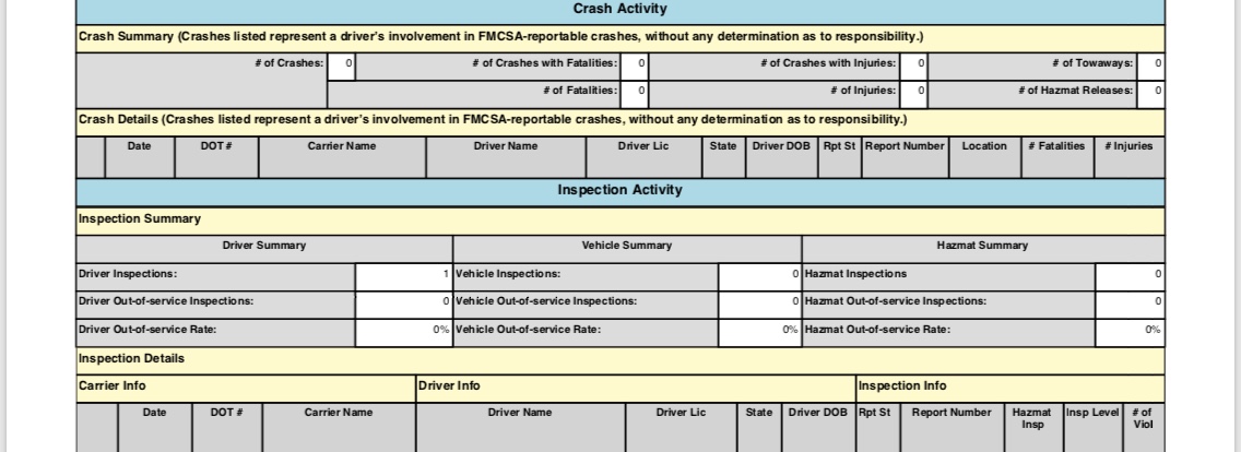

    The company gets the points .
    Your PSP will be clear besides under the driver summary and vehicle summary for inspections ; And since you received no tickets, there won't be any violations listed . It will simply have the number of inspections done
    The only way this could really hurt you is if your current company uses hireright/dac and puts something down like "Terminated for falsifying logs" and then your prospective companies use hireright /dac and see that listed
    Bean Jr. Thanks this.
  8. gpf87
    gpf87 Heavy Load Member
    765
    882
    Feb 2, 2017
    0DC5AEB5-1FB3-4D97-8905-5598D3D17F23.jpeg This is what the psp looks like . I cropped out my personal info from the top and bottom but you get the point
    Tombstone69 Thanks this.
