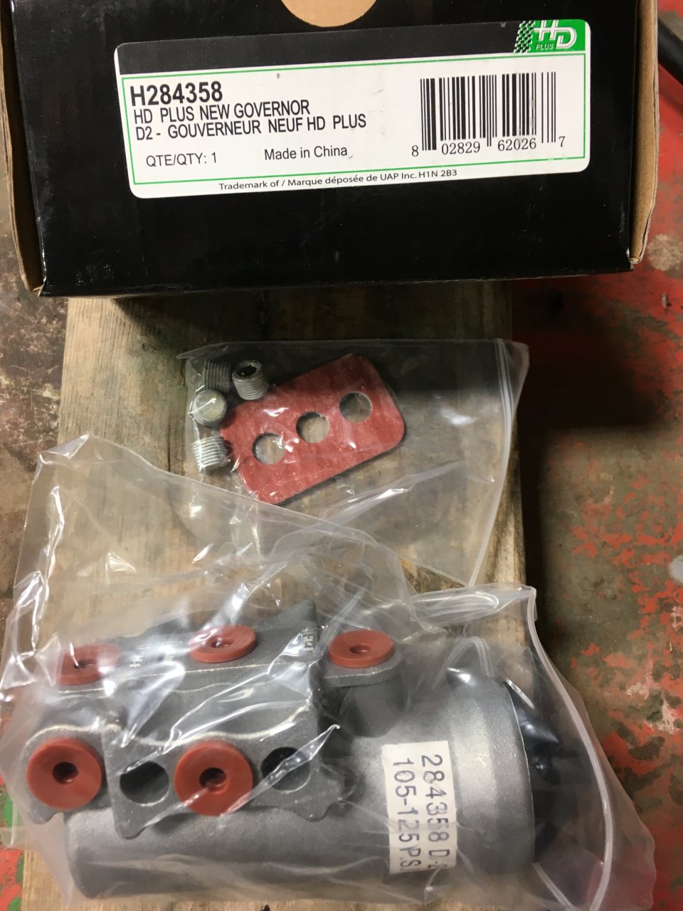

  6. SAR
    SAR Road Train Member
    2,756
    36,654
    Nov 26, 2011
    ND
    I bought this at a Napa store, it's got everything you need in there, new governor, gasket, and plugs. I would just replace the one you got that is leaking. Like someone said they are very inexpensive. Before you take the old one apart just remember where all the lines and plugs go so you can match up to new one. Good luck
