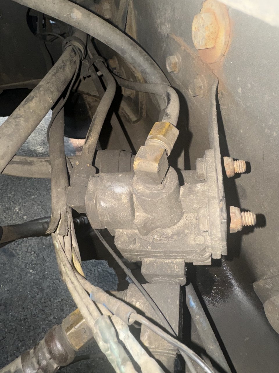

    Ok will take a pic of it hopefully u still around. If I disconnect all the lines from the chamber it would have to be that one you think?
  3. Big Road Skateboard
    6,655
    37,368
    May 2, 2021
    Yes. To verify, you can pull the small air line off that runs from the quick release valve to the ABS valve. If you release the brakes, and air leaks out from the QR valve side, the QR valve is bad.
    Very simple to check. Should be the air line goung to the top of the QR valve, usually on a 90* fitting

  5. stylez80Nine
    stylez80Nine Light Load Member
    185
    58
    Dec 2, 2018
    Is this the one you’d speaking off and to removes those two small line? Again thank you so much for the help.

  8. stylez80Nine
    185
    58
    Dec 2, 2018
    Hey so I disconnected like you said and air is coming in on 1 (photo provided ) and coming of 2 does that mean it’s bad?
  9. stylez80Nine
    185
    58
    Dec 2, 2018
    Air is coming in on 1 and leaving on 2
  10. stylez80Nine
    185
    58
    Dec 2, 2018
    Sorry for all the reply and when I cover 2 with my finger it stop leaking.
  11. Big Road Skateboard
    6,655
    37,368
    May 2, 2021
    Air should not be coming out the top port
