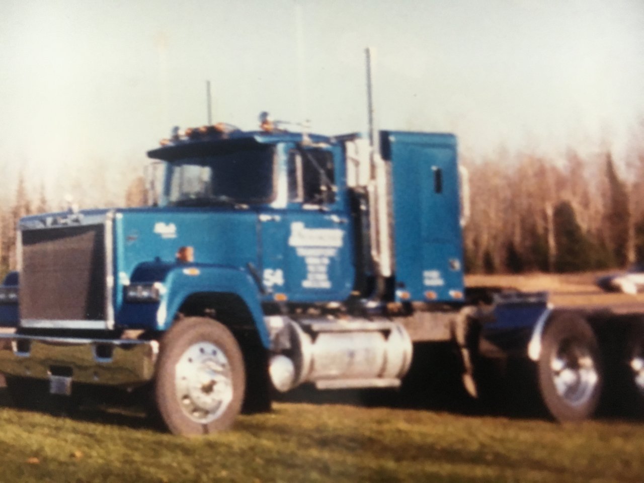

    I drove one just like that early in my career. It was a long legged old truck and rode really nice
