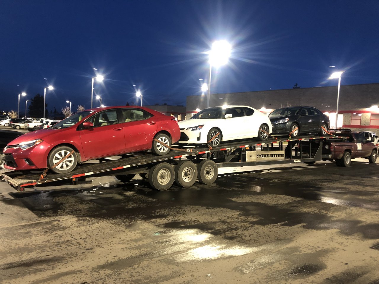

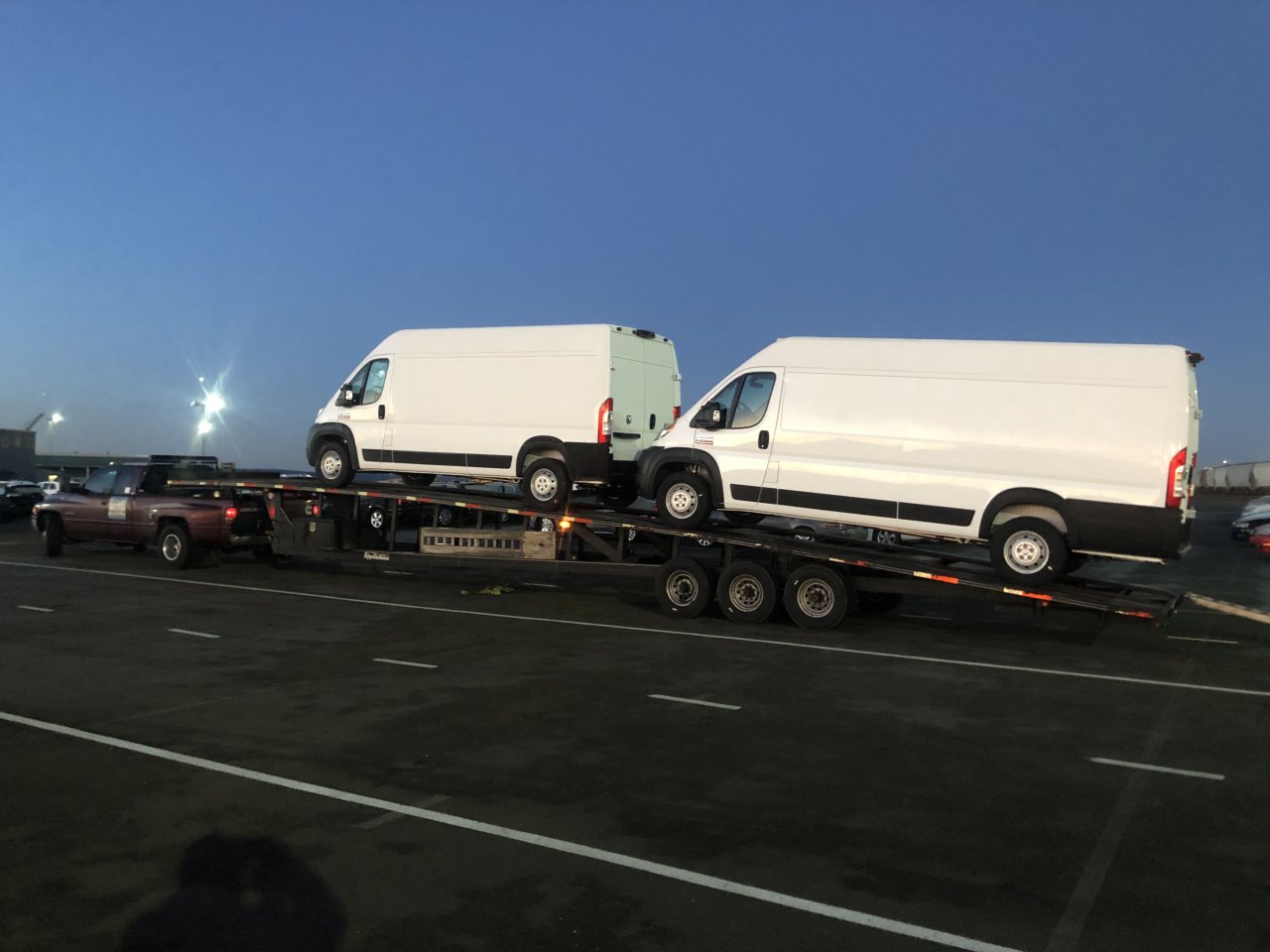

    3F5FEDAB-C159-4AFD-B6BF-3A1AC0B5F6F0.jpeg D15662A0-58AA-42BA-A172-3E5338857035.jpeg With my old 1 ton (2001 Ram 3500) I ran without CDL and was legal. Truck was rated for 10,500 and trailer has a 14,000 rating even though it has 3x7000lbs axles. So gcwr of truck and trailer was 24,500. Rolled thru a scale in Oregon at 25,900 and of course got red lighted. After some discussion why I didn’t have a CDL , no Oregon trip permit or cab card I was on my way without any tickets or out of service. I’m speaking from experience. Yes yeah can run this way and I did for over a 100k miles and made some good money. If you happen to be over the 26k mark just make sure your not willingly going into a scale ;)
    Recently bought a new dodge and it’s rated at 14k so had to go get my CDL. On a side note, still have the old dodge and the down rated trailer I’d be willing to sell.
