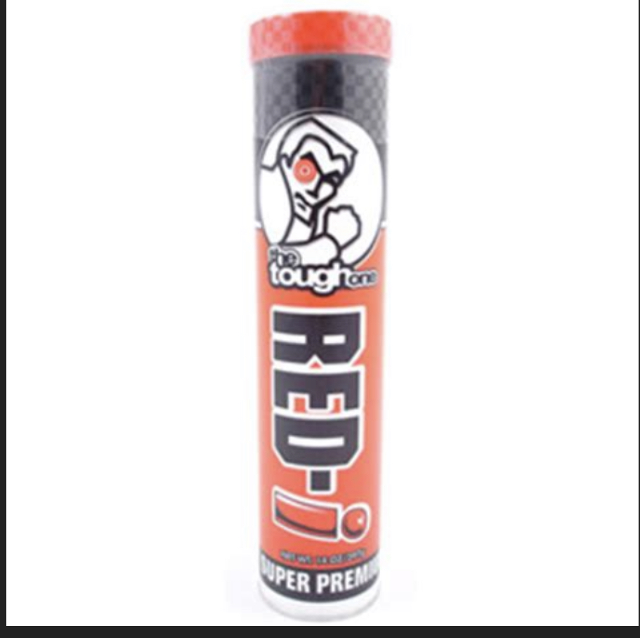

    41F02293-C3EB-4157-9E25-979A181F6F61.jpeg I’ve tried all or most of the premium grease, even Lucas, and Red-i is still my top choice. The only “con” is that’s it gets really stringy in the cold. That should be proof enough it does it’s job and beyond.
