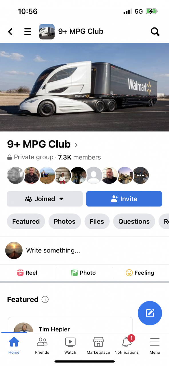

    You’re in the wrong place. Join the 9+ FB group. There are a couple guys there pushing the envelope with LiFePo. You’ll have to scroll down quite a ways, but, the posts are there.
