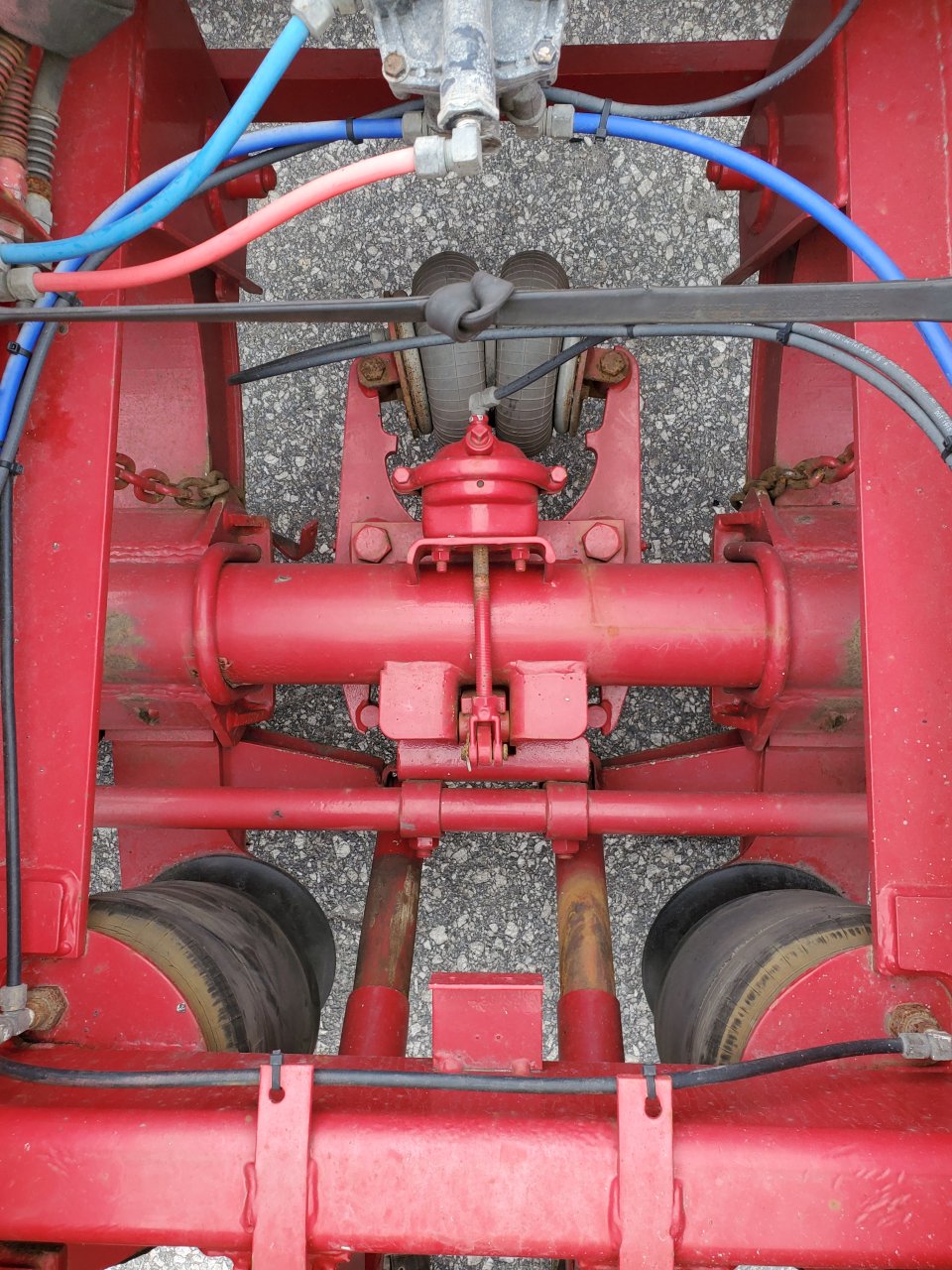

    New Holland, Pa
    The pin-on to the red XL I pull occasionally is self-steering. But locks in place for backing up or other needs. Obviously this axle doesn't lock what is a cool concept for steerable axles. 20200901_093615.jpg

    All of our stretch trailers are self steering. They usually are steering about a foot to the right when stretched and we don’t have any control over them!

    Are they cable controlled off the fifth wheel?
