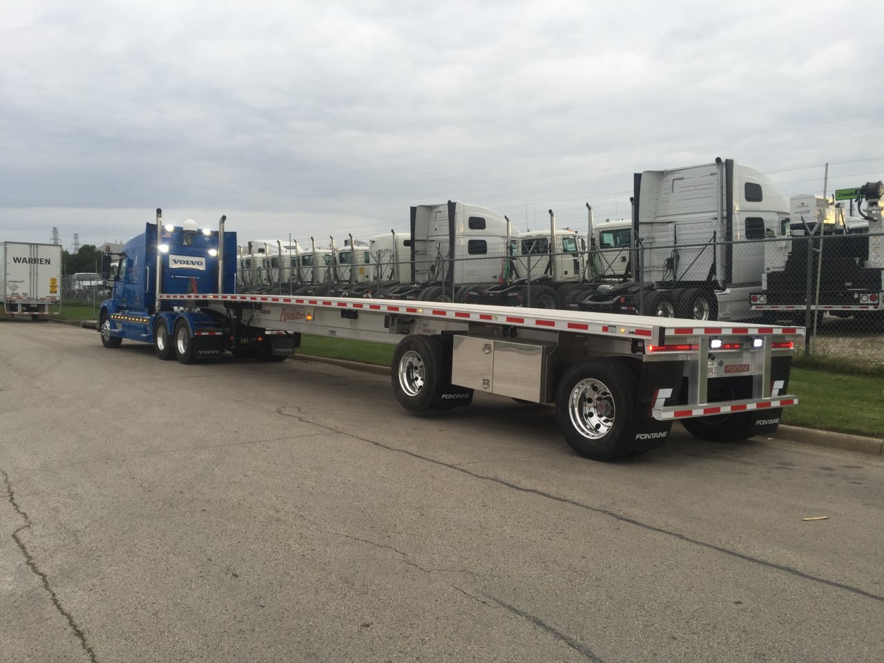

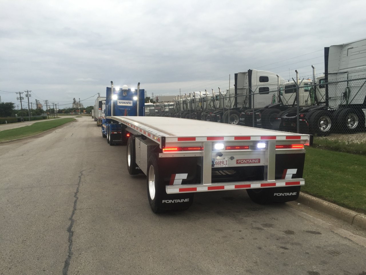

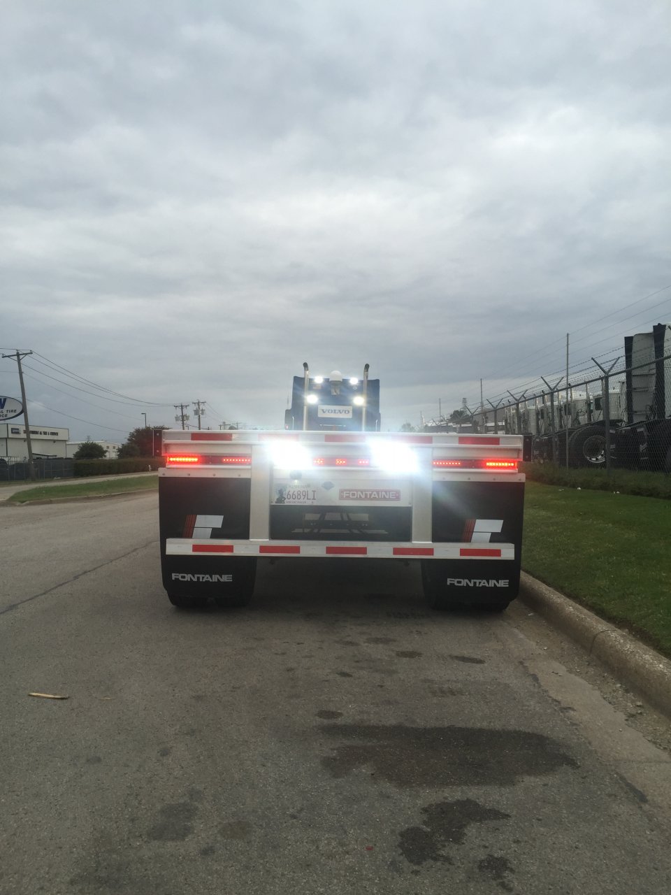

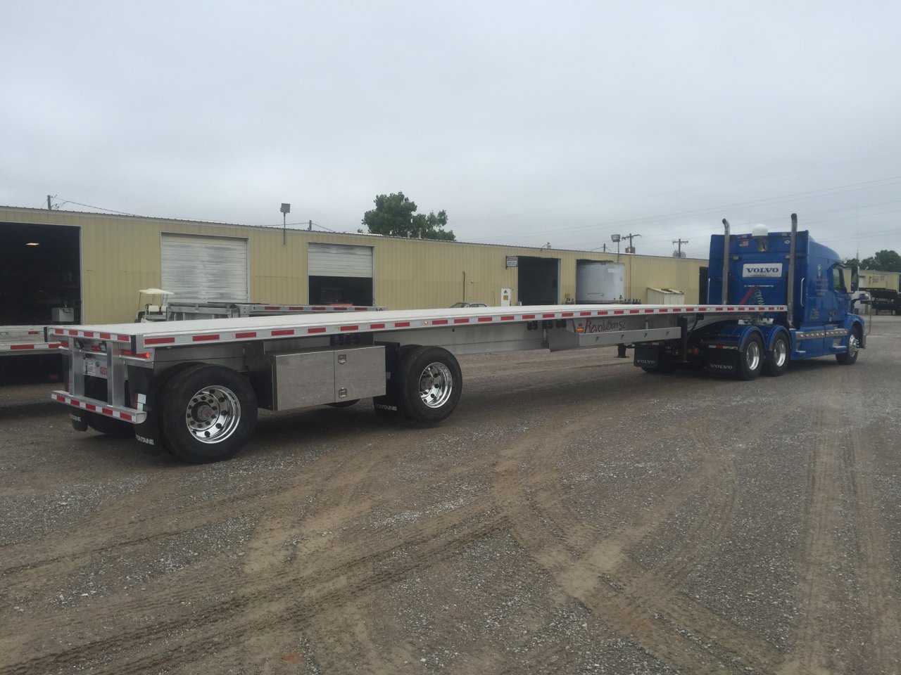

    I just bought a new Revolution and got a lift axle.
    Love it, saves fuel for sure and when empty it throws a bit more weight on the drives.
    I bought a 2017 model that was already on the ground which had a reasonably nice spec, then had the dealership add what I wanted. The only thing I have to get added is the Tire Pro inflation system. I needed this trailer in a hurry (hence buying one already on the ground) and couldn't wait the two week back order for the inflation system. I can bring it back in whenever it suits me to get it installed.
    Here's the trailer spec order:
    Front lift axle manual & wired to pin on front of trailer.
    Dump on rear axle wired to pin on front of trailer.
    Hendrickson tire inflation/deflation system.
    Aluminum Fontaine dunnage rack on passenger side.
    Locking polished tool boxes on both sides c/w floor securement articles.
    12 sliding ratchets & 12 sliding rope hooks on drivers side.
    6 sliding ratchets & 12 sliding rope hooks on passenger side.
    All aluminum wheels durabright outsides.
    Led backup flood lights wired to pin on front of trailer.
    Right weigh digital load scale mounted on drivers side.
    MJ1657 and daf105paccar Thank this.

    How much did they tell you it would weigh, have you had a chance to unhook it on a scale anyplace to find what the real weight is?

  11. Foxcover
    Foxcover Medium Load Member
    413
    217
    Nov 22, 2011
    Dallas, TX
    With all my stuff in there it weighs 9,480lbs. The trailer weighed 8,800lbs bare.
    Unfortunately I should have ordered this a couple of months ago when I contemplated it. There's a 60 day wait from the factory on high spec special orders.
    The result of waiting now became trying to get a well spec'ed 2017 model trailer already on the ground and adding what I wanted as I need it to fill in gaps when the weather is bad.
    I was still going to wait because I was hell bent on disc brakes and nobody seems to order stock with discs, however drums have become so light and durable that there was no weight savings in comparison. In fact to my surprise the discs added a little weight.
    With that said I figured I'd loose more by waiting cause the weather looks like its going to stay stormy for the next 6 weeks at least, resulting in more lost days and weeks of revenue this year. I have a good gig I can do with this trailer running locally on days that are too wet for my dump trailer. I just needed to be able to scale 48k lbs, my tractor is heavy.
    I've been dealing with Steve @ Superior Trailer Sales in OKC for years and they usually order their stock with a decent spec so here we are.
    I also found out that high spec orders don't have everything installed on the assembly line, stock trailers after assembly are taken to a different part of the factory to have optional extras added so there's not much difference doing it there or at a dealership that does tasty work.
    If I did order straight from the factory here's what I would have added to the current spec.
    All steel components (landing gear, axle assembly's, hubs etc) painted company colors.
    Probably would have went with discs but I'm very torn on that still.
    Dunlop or Michelin tires, (They come stock with Chinese tires but seem to hold up ok).
    Clearance lights every 2' down the side rails of the trailer. (The wiring on these trailers is awesome unless you want to splice into it, voiding the 10 year warranty on wiring & lights) so adding them after isn't really worth it.
    Adding a few more chain ties in the floor but they already have a good amount.
    Small fenders in front of the front axle.
    The only thing I'm worried about, I'd have ordered an 18"-24" kingpin setting, standard is 30". I've a heavy front axle and run my fifth wheel right up to the front drive axle.
    Sure, having a spread on the trailer makes it easier to not go over axle when loaded to gross (hence why I run extra weight on the steer when pulling the end dump on tandems) but I hope I don't have to dick with the slider every time I change trailers.
    All this stuff (other than kingpin setting) really makes a trailer truly unique but has no real or very little practical advantage. All the other stuff that I added will however help save money, time or sweat which are one of the same to me! Lol
