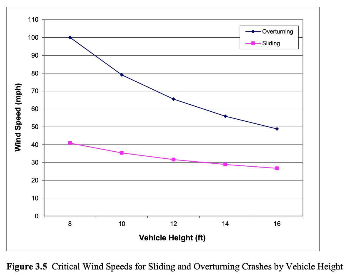

    These charts show when it is most likely that there will be a crash for semi-trucks. (5% deflection for sliding)
    Screen Shot 2020-01-07 at 10.56.50 AM.png Screen Shot 2020-01-07 at 10.57.27 AM.png
    These numbers are not exact and they are not gospel but just hints based on what is known today. If you look at the chart <35,000 pounds according to a study by Nevada is a risk at 60 MPH which is when Wyoming issues the warning.
    If you are the type of driver that is willing to slow down as much as needed and who remembers to keep some RPM available when going down a grade to recover from a trailer slide you will fair better. If you ignore cyclic increases in trailer deflection, or drive as fast as you can to satisfy your get-there-itus you will be at a much higher risk.

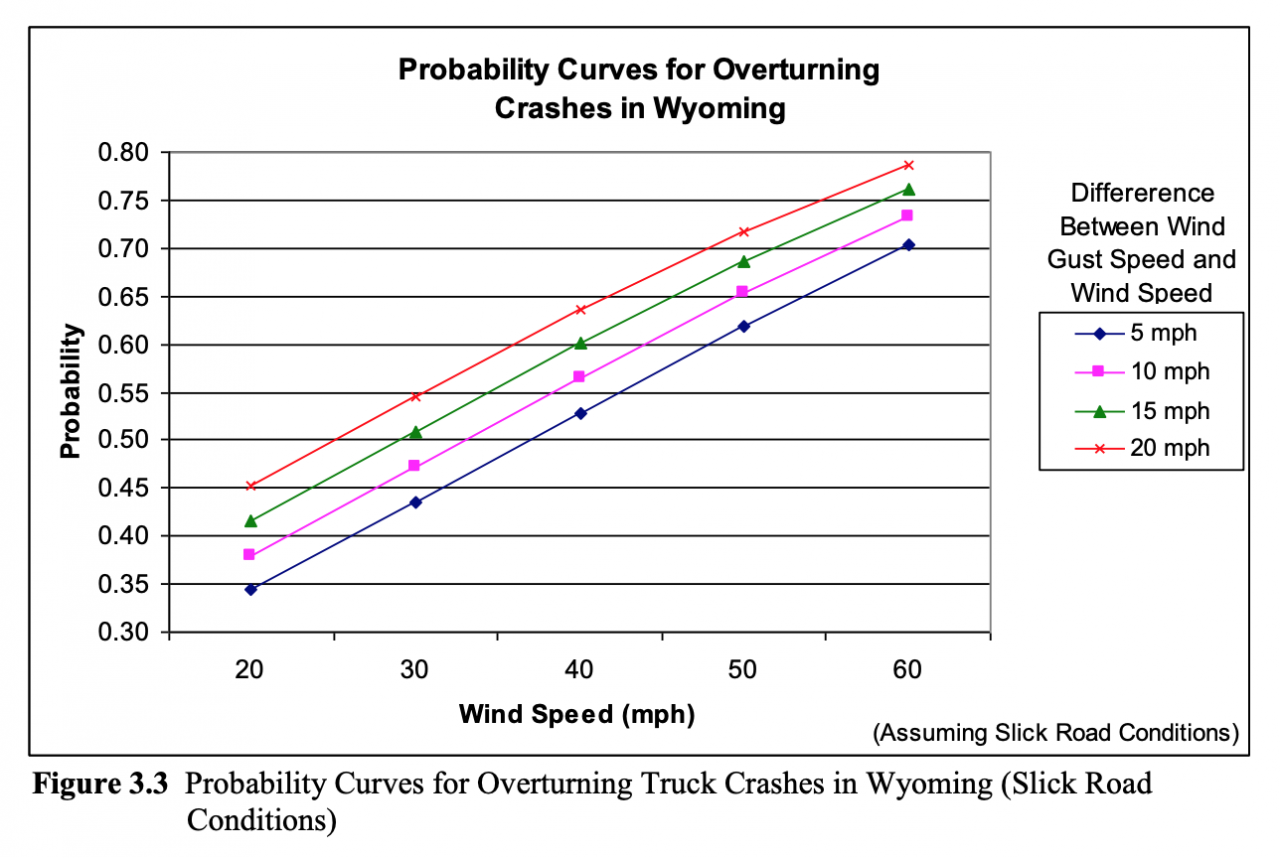

    Here is how grim the stats are. (0.60 == 60%)
    Note that overturning are far more likely to shut the road, which is why they wait until 60 MPH today to provide a warning. But even at 30 MPH winds slick roads gives a 50:50 chance that someone will overturn somewhere in the state. Remember that 30 mph to 60 mph is eight times as much force.
    We are our own worst enemies here, only slowing down and/or stopping will really make this safer and help reduce the number of closures to clear.
