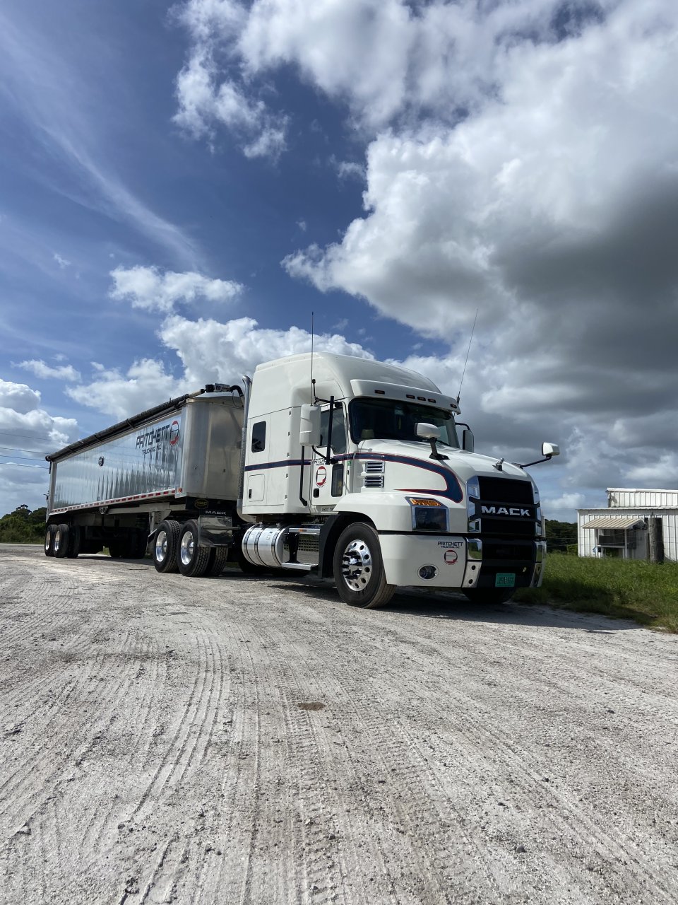

    32,600 full of fuel with an APU, no liner double wall. Previous Mack wasn’t an Anthem and had no APU, same trailer. 31 and change. 78A992EF-08DC-4F19-9AD9-32576E63F7D3.jpeg

    I’m not sure what you’re looking to haul with the single wall Ravens, be mindful they will puncture easily if you get in to any kind of bulkier scrap hauling.

    Nothing too big. Most of what I haul is smaller stone from quarries or finer material than that. It's the same work I've been doing for years in single walked dump trucks so it should hold up ok I would hope. I appreciate the info on the weights.

    Get the VIN number and call Raven or which ever manufacturer made the unit. The have a record of the weight of the unit when it was new. Keep in mind that there may have been patches to the trailer and a liner added which would change the weight.
