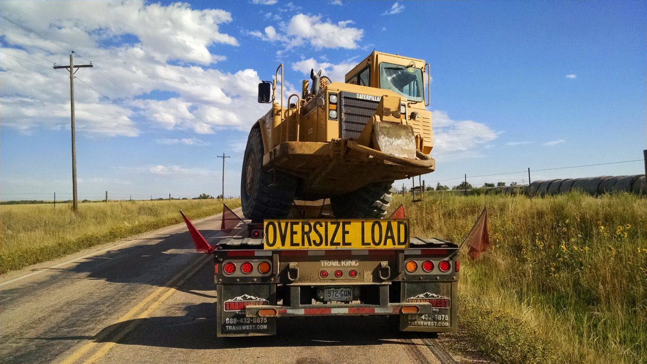

    IMG_20140903_093248717.jpg A pick up stopped to turn in front of me. I was doing 55mph. He had no turn signals or brake lights. Snapped the 2 inch hook. Thank god i had this chained down with 2 on the front of the cab, 2 crossed on the back. 2 crossed on the can and 2 on the rear. Never under estimate. Error on the side of caution.

  11. Landincoldfire
    Landincoldfire Heavy Load Member
    895
    4,870
    Sep 27, 2015
    New Holland, Pa
    So you had to climb up there and steer it to the side for a better picture. Lol
