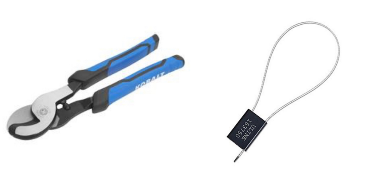

    78724C79-5A88-43A0-B48D-E88CEC10DD0A.png It depends on what you’re doing, but one thing I’m picking up tomorrow is a decent pair of bypass wire cutters for cable seals.
    Lepton1 Thanks this.
