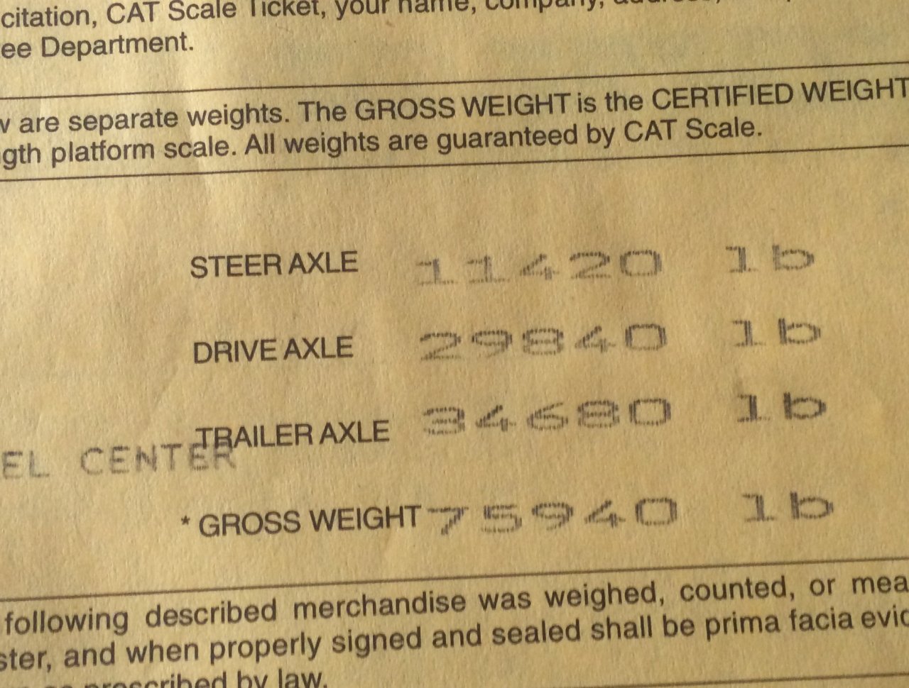

    People who "load them all of the time" don't necessarily know what they are doing. I don't know how many times I've heard "You're legal to 40K" as their justification for loading it wrong. Just because something is LEGAL doesn't make it RIGHT! Move the load forward, or find another truck. A lot of these "knowledgeable" loaders only THINK they know what they are doing because nobody ever comes back to have their load reworked...but that's more because the drivers are on the clock with a time deadline and don't have time to deal with getting a less-than-ideal (but legal) load redone CORRECTLY, so they just roll with it...especially if it was more than a few miles to the scale, nobody likes to backtrack and delay, not to mention messing with straps, chains, tarps, etc. more than absolutely necessary. So nobody comes back and they think they got it right.
    That's the problem with centering the load on the deck...weight is biased to the rear and you end up stupid heavy on the trailer axles. If your trailer was at or near 40K, and you were tipping the scales at 80K, that leaves 40K for the tractor's 3 axles. If you figure 11-12K for the steer, your drives were extremely light at only 28-29K...which is WHY it rode like crap and pulled like crap.
    By moving the coil forward a little, it would have made that load much easier to pull.

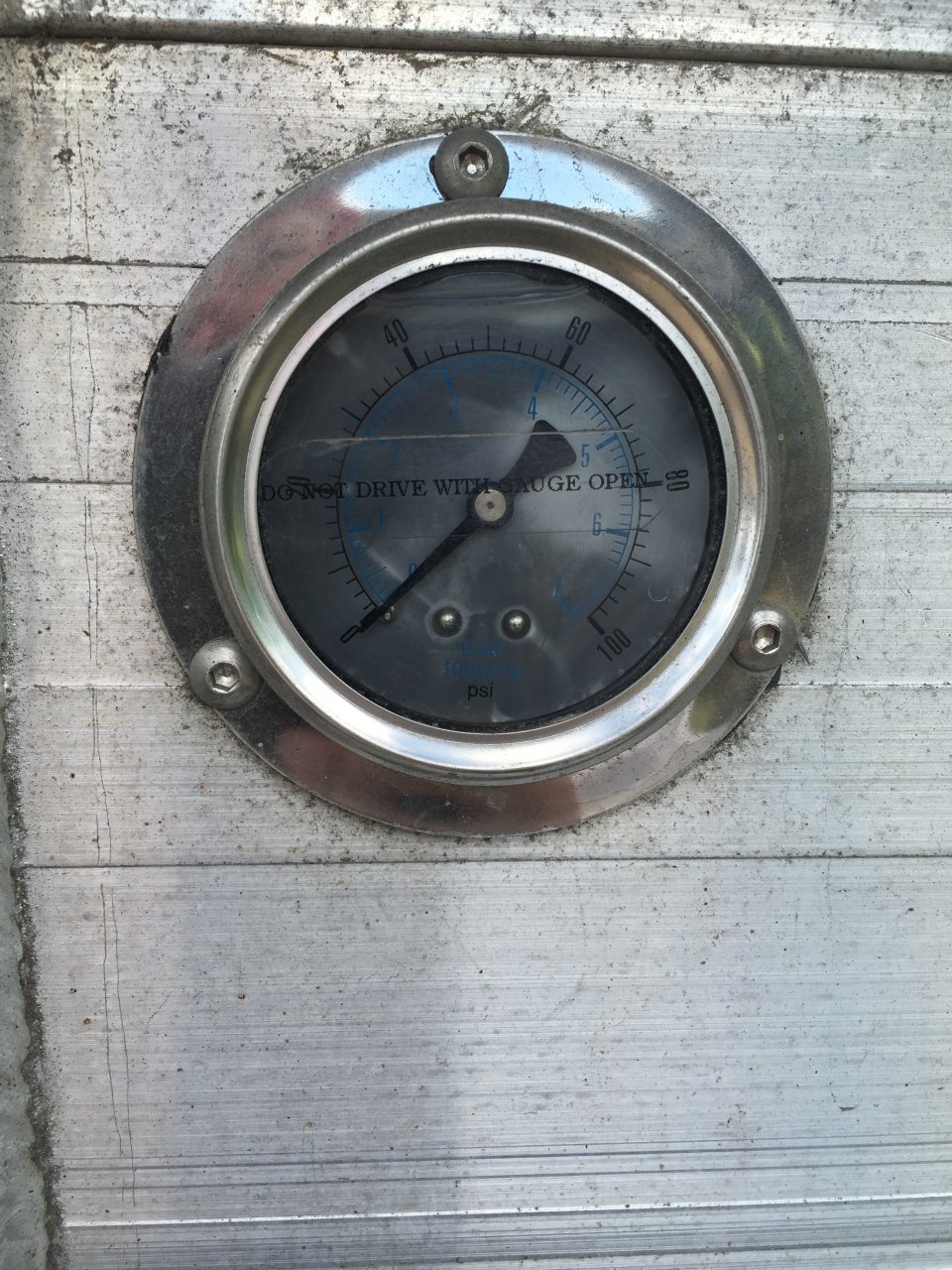

  8. Riprap
    Riprap Light Load Member
    286
    1,979
    May 31, 2014
    Saginaw, MI
    Speaking of gauges, why do they turn black? I put this one on a few months ago and it's already trashed image.jpeg
  9. cnsper
    cnsper Road Train Member
    5,869
    27,421
    Feb 28, 2014
    Probably from some dyed or painted material inside the gauge. That is not trashed, you can still easily read it.

    So if a coil weighs 21,000 pounds, and is 5' in diameter, it weighs 4,000 lbs per foot? I'm trying to understand the math a little better.
    I loaded two coils on Friday. Equal weights on the coils. 53' flat, open 10' spread. Center of my tractor drives to center of spread was 40', so measured and marked the trailer at 20'. I set up two coil bunks, the front one was ahead of the 20' mark. The other one was behind.
    Now, the loader was going to try to put both in one bunk. So I moved the front one back 2' so it was more centred on the 20' mark. He placed both coils there, then decided to split them up, one in each bunk.
    So how much weight did I move when I moved the front bunk back?
    If I reloaded the front one, one foot ahead, would it move 4-5000 off the trailer group and place it on the truck?
  11. haulhand
    haulhand Road Train Member
    A good rule of thumb is about 1k per foot you move either direction. So if you want to move 4k forward you need to move just under 4 feet. Your thinking in the right direction but the diameter of the coil doesn't really matter all that matters is what is touching the dunnage and trailer so if your 5 feet shrinks down to 2 feet where either end meets the dunnage all the weight is sitting in those two feet.
