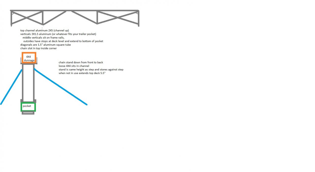

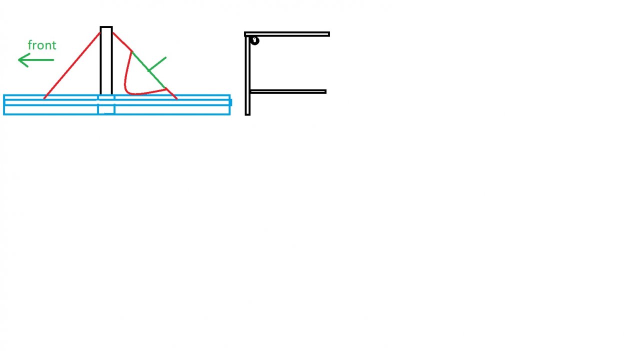

    the load levelers I have used locate in a stake pocket and need to be chained down to prevent collapse.

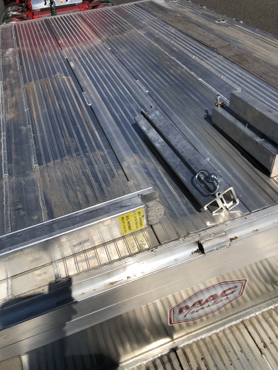

    i have the leveler ramp combo set never used the levelers, use the ramps constantly
    i need to get the right lumber for the clips on top of the levelers to finish out to correct height; they sent the clips but i never got the lumber
