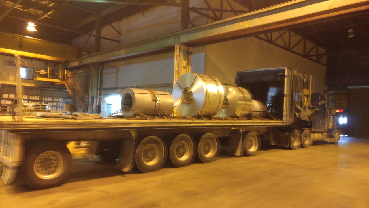

    20180925_113118.jpg Got a formula for that? ;) just teasing. Sometimes you just got to do the best you can. Axled out ok like that. Thought l shoukd have moved the big coil back a foot and the last one back afoot too. Next time.

    Michigan trailers don't count, lol.
