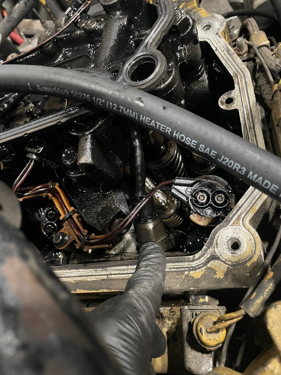

    2006 C13 acert motor . I’ve been back and forth to the cat dealer and my mechanic . The code that pops up is for the intake valve actuator oil pressure voltage high. Where is this sensor located . Is it inside the valve cover or on the side of the head ? Pic for code

    You found it. Sensor failure is common.

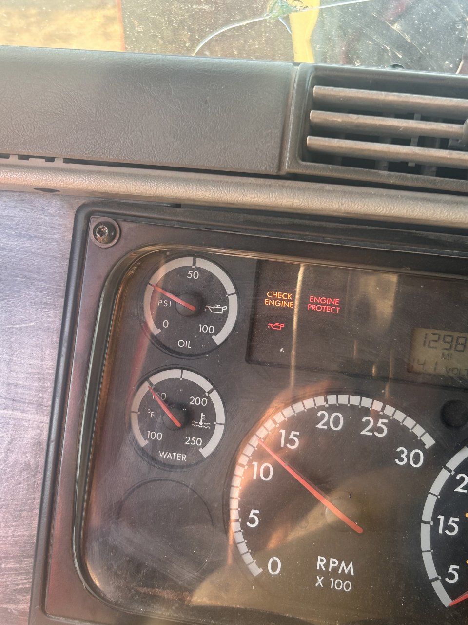

    What are the symtoms for a bad actuator? my low oil light comes on accelerating to a higher idel but when let off throttle lights shut off already replaced extrnal oil, pressure sensor. Trucks runs and idels the same
