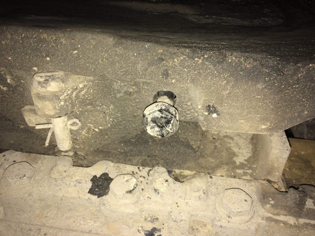

  9. passingthru69
    Looks like the jaw adjustment bolt to tighten or loosen the locking jaw don't go messing with turning it unless you know what you're doing. To loose and you can lose a trl going down the road
    ExOTR and pattyj Thank this.
  10. 062
    062 Road Train Member
    6,151
    33,231
    Oct 20, 2013
    That bolt has a spring behind it. Should be able to press it in a 1/4-1/2 inch when hooked to trailer. If no play in it that's your problem.
