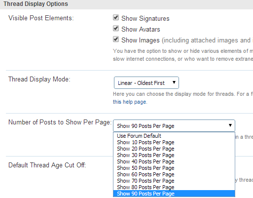

    We're still on page one, n00bs... ;)
