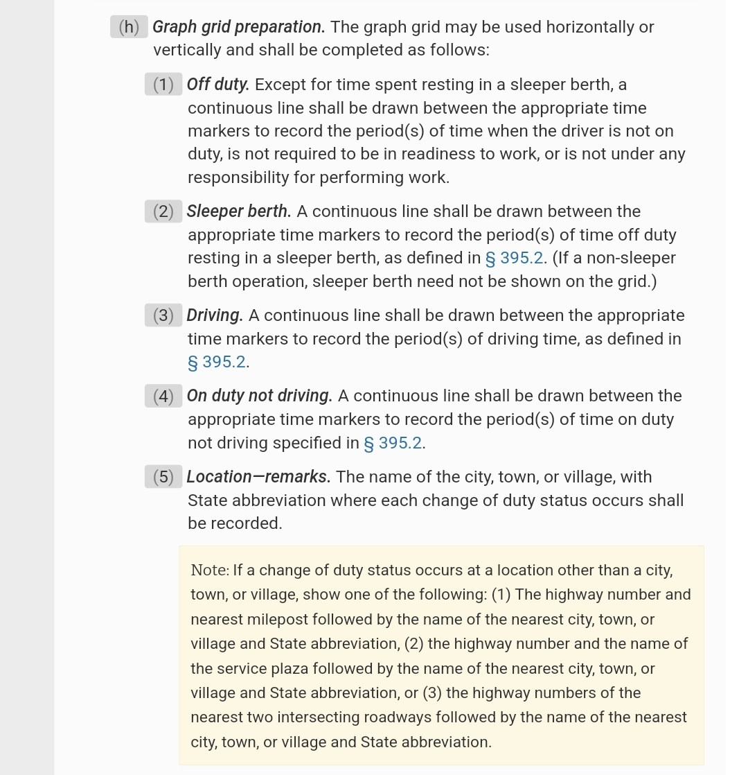

    I actually thought you found something there lol. They are in fact saying “you shall draw a continuous line” and not saying how to log your status. They want drivers drawing a continuous line but not 2 lines when off duty in the sleeper berth when using paper logs.

    It’s very simple really. You never have to log sleeper unless you are a team driver or if you take split breaks.
    Unfortunately we have drivers that refuse to admit they are wrong and just want muddy the waters.

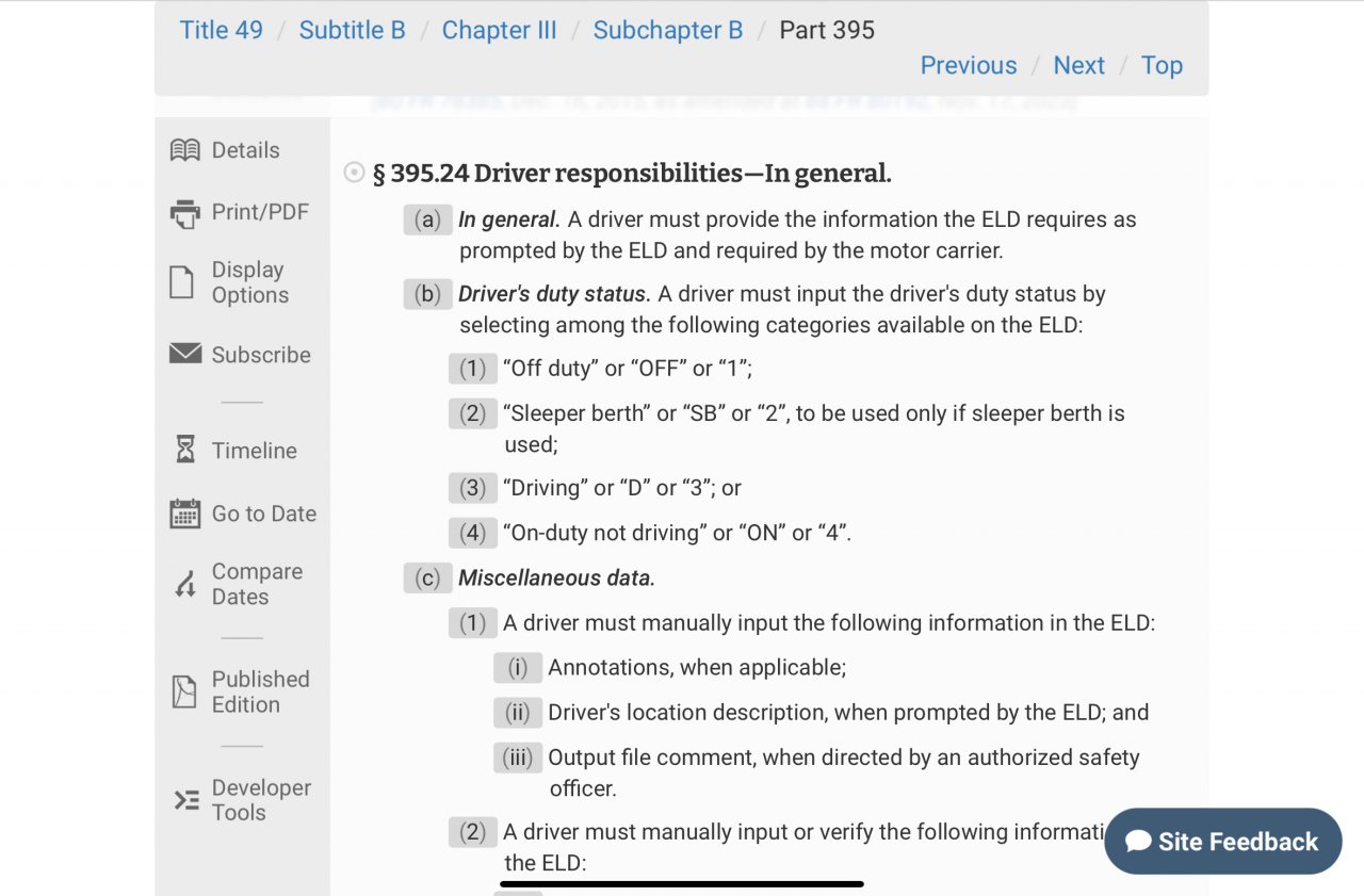

  9. Thrasher28
    Thrasher28 Road Train Member
    1,238
    3,503
    Aug 12, 2021
    Bowling Green, KY
    That's true. There's a monetary motivation for most violations not being fixed immediately. Or a reason, such as a poor pre trip or happened while rolling down the road and driver is unaware. There's no good reason to not just move a finger 5cm further down and click sleeper berth instead of off duty if you're resting in a sleeper berth other than hardheadedness.
    Its free of charge, more descriptive, more clearly indicates rest, and I'm no lawyer, but I interpret the regs I posted yesterday as it being a requirement (could be wrong about that).
    There's no reason to raise eyebrows unnecessarily.
    And as a side note, I've incorporated off duty more often into my logging if it more accurately reflects what I'm doing. Why? Cause it's free of charge and there's no reason not to. Same way there's no reason for me to not log my sleeping last night as sleeper berth.
  10. 4wayflashers
    4wayflashers Road Train Member
    1,066
    1,235
    Mar 14, 2014
    That section is how to prepare the grid. It’s saying to draw a continuous line. The section immediately before it refers to the duty status and does not have the same wording IMG_0259.jpeg
